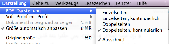

Margins can be adjusted from the Sections palette group under Margins (Seitenränder), and in Page view (Seitenansicht) you can drag the page guides.
To get something like in Nisus Writer 6.5, you can use the Print command, and in the Print dialog, press the Preview (Vorschau) button.
Then in Preview programme you can view one or two pages:
but you cannot change the margins here like in Nisus Writer 6.5.

on this point Nisus Writer 6 was better. Now I can do almost the same thing on "Seitenansicht", but you have there no indication in cm.
