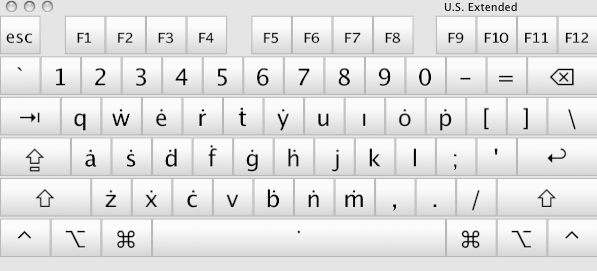

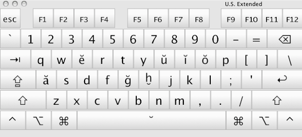

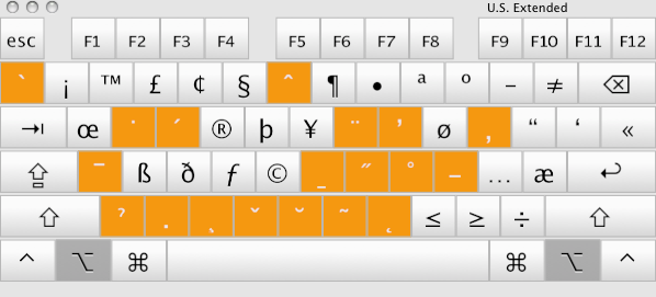

Uncommon characters used for transcription won’t be found your keyboard layout. A keyboard layout available on the system that you can use is the U. S. Extended keyboard layout. Special characters are obtained by pressing a key with the alt (Option) key followed by the character you want, for example alt-x gives dot under characters, so if you want a ‘d’ with dot below, press alt-x followed by d. Other examples:
alt-x gives dot under characters:
Ḍ ḍ Ḥ ḥ Ḳ ḳ Ṣ ṣ Ṭ ṭ Ẓ ẓ
alt-a gives letters with macron:
Ā ā Ī ī Ū ū
alt-v gives letters with caron:
Ǧ ǧ Š š
alt-h gives letters with macron below:
H̱ ẖ Ḵ ḵ
alt-w gives letters with dot above:
Ṡ ṡ
etc.

Orientalist wrote:a "g" with a dot above is missing. And the h with a ˇ but bezond the h and other waz around is missing
Using U.S. Extended keyboard layout . . .
• hit option-b (dead key), then hit h and you get ḫ
• hit option-b (dead key), then hit H and you get Ḫ
• hit option-w (dead key), then hit g and you get ġ
• hit option-w (dead key), then hit G and you get Ġ
as shown by Keyboard Viewer (System Preferences > Language & Text > Input Sources in Snow Leopard).
