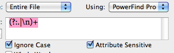

Re: Search for highlighted text
You can do Attribute Sensitive search, for example.
Thanks. This got me started, but I found that my search does not capture all the text that is highlighted. I've tried all of the various wild card options for "underneath" the highlighting, but none of them captures all of the various highlighted elements. I think between them all I should be able to do so.
Thanks, Hamid and Martin.
I finally figured out what went wrong. I had originally copied and pasted a selection into the find window. I then selected the text and replaced the text with the Anything wild card bubble. (At first I was unsure how to highlight the text in the find box, so I had used this method.) Because there were other attributes involved with the original text and because those attributes were not shared by all highlighted text, only some of the highlighted text was found.
Once I figured out how to highlight the text in the box via the Format menu all was well. (The highlight button in the toolbar does not work to highlight text in the find box.)

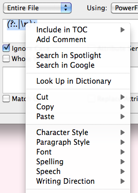

Toolbar buttons apply only to the document window, but I think it would be a good idea to have highlight included in the contextual menu available in the Find window. Other attributes are available there. I also notice that having 'Add Comment' in that menu does not serve any purpose:ProfT wrote:[...](The highlight button in the toolbar does not work to highlight text in the find box.)
Agreed. The contextual menu was the second option I tried to introduce highlighting to the find expression. When that failed, I performed the copy and paste that sent me down the wrong path. It would be a great addition to have highlighting available in the contextual menu.
