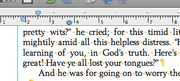

I am using v. 1.3.1 on Leopard.
I noticed that when you set a tab by clicking on the ruler, and you have an indent mark selected, the indent mark is moved along with the tab. In other words:
1. Click on an indent mark in the ruler to select it.
2. Click anywhere on the ruler to set a tab (any tab).
3. Selected indent mark is kind of attracted by the tab.
This picture should be self-explanatory:
Picture 1.png (28.57 KiB) Viewed 2986 times

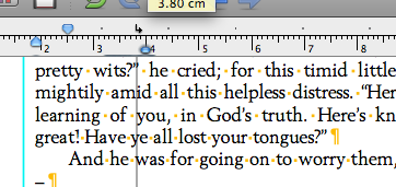

And this is what I may (but not always) end up with when I delete the tab:
Picture 2.png (25.49 KiB) Viewed 2983 times

Re: A glitch with tabs
This bug appears to have been introduced in NWP 1.3, and isn't related to Snow Leopard. We'll look into it, thanks Henry. For now you can work around it by deselecting the indent marker (Command click) before creating the tab.
