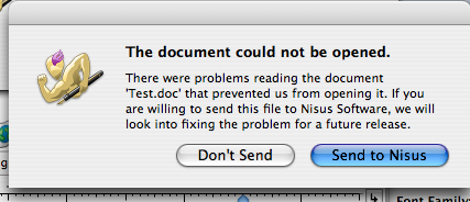

The docs open fine in word. If I resave them as rtf or another format, they will open in Nisus.There were problems reading the document 'anyname.doc' that prevented us from opening it. If you are willing to send this file to Nisus Software, we will look into fixing the problem for a future release.
Document Could Not Be Opened
I keep getting this error with .doc files. Any ideas on how to fix. The error reads thusly:

That's correct. I'm running NWP 1.2 on Mac OS X 10.4.11 on a G5 Dual 1.8. I sourced this document in ms word on the same machine. It works fine in ms word, but it fails to open in NWP. I have re-installed NWP, but I get the same error. Attached is a png that shows the error. The error follows a status message that says it's looking for a filter.Your Test.doc document opens fine for me using NWP 1.2 and Mac OS X 10.5.6 (Intel) - it contains just the word "Test" (Times New Roman, 12pt) right?

Version 1.2 introduced an all new ".doc" file converter, so that's not unsurprising. It's actually somewhat good that it's behaving consistently bad on your system, and the failing wasn't caused by something you installed recently.mwiseman wrote:I'm pretty sure the problem began when I installed NWP 1.2. I don't use my laptop as often and usually in a hurry, so I've been dismissing the upgrade notifications on that machine, which continues to work.
