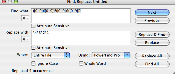

Re: Problem with digits when open old Nisus Hebrew files
Hi Shlomit.
This is a general problem when moving hebrew files from system 9 to X.
The solution is to use find and replace in the following manner (At least this is a working solution for me). It relies on you knowing what is the highest number of consecutive digits that needs to be 'switched'. (in your example it is 3, as you have spaces within the numbers):
Open find and replace window and type the expressions from the enclosed image. this is suitable for up to 4 digits. if there are more (say 5 max) - add another ([0-9])? in the end of the "find' winodw, and add \5 at the beginning of the 'replace' expression.
(be sure to select "powerfind pro" ).
I am sure this could be transformed into a macro/script that will be uniform for all files, but in most cases it serves quite well.
I hope this helps..
Ruchama
I hope this helps..
Ruchama

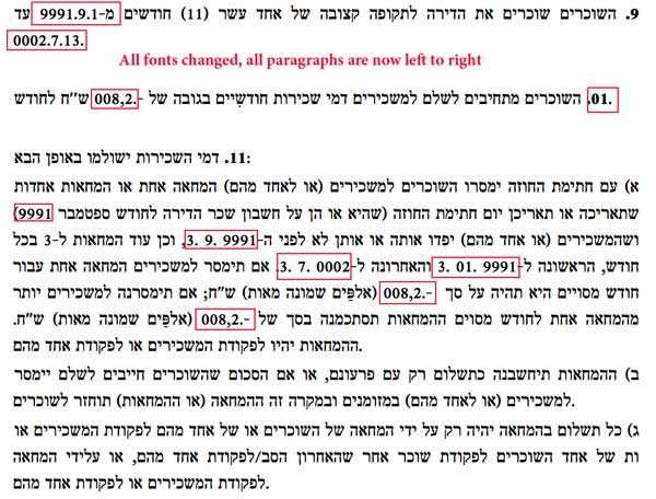

well,
I guess making an application that uses Apple's support for Hebrew is not a good idea.
Apple never invested in true Hebrew, I can see that when comparing to the excellent work Winsoft invested in Hebrew for Adobe Applications.
I never had issues with opening old InDesign files, digits and text where never flipped or change their direction, and getting used to such high standards, for sure causes disappointment with other application that can't treat Hebrew well enough.
I can't understand why opening an old Nisus document will cause the digits to change, the Paragraph direction to become a left to right, the fonts to change etc. I do believe a document should preserve all Paragraph and Character definitions and regarding fonts, it should ask me which font to replace when it see's there is a missing one.
Opening an old Nisus file into Nisus Writer Pro, and not see the exact definition as used to be, is a big problem to my understanding.
In the attached screenshot, you can see how dates change, number like 2,800 became 008,2 etc.
In some cases I can't even know how it shold look like unless i have an old document printed or pdf from the previous version.
so...
this is causing a smile on my face....
thanks anyhow
so...
thanks anyhow
Don't know again -
but maybe your last thread is the answer - "View/Show Invisibles"... Then look for the Reverse Directionality Marker at the Numbers to delete - again don't know about Hebrew. But there was the "Convert to Reverse Order" Menu option to fake "Right-to-Left" writing in Classic Nisus Writer. That's obsolete now with OS X and Unicode text engine - but again who knows?
HE
HE
Ruchama put his finger on it, but didn't spell it out. Word, OpenOffice, NeoOffice, Mellel and InDesign all use proprietary text engines, as did Nisus Classic ... For good or ill, in creating Nisus Writer Express and then Pro, Nisus used a pretty much modified version of the Apple text engine, and that's why these problems arise. NWE/P is very much more capable than the basic Apple text engine, but still issues remain which will presumably be ironed out as versions progress.
If Open/NeoOffice or Mellel work for you, go for them. I ought to try the new version of Mellel since apparently they have finally made it able to import Word files written in Chinese; NeoOffice is better for Chinese than OpenOffice, but neither of them, to the best of my experience will allow you to mark a stretch of text as being in a given language, which NWP will do. Mind you, Word apparently won't either, from all the files I have to work with generated in Word running under Chinese Windows. So all of these applications, whether using their own text engine or not, have their lacunae ... It comes down to which lacunae cause you as an individual the most or the fewest headaches.
I would love to use InDesign much more, but I only have CS1 and can't afford to upgrade ... and CS1 won't run properly under Leopard. Also, I have to say, NWP handles Chinese more intuitively.
Just to make it clear.. Ruchama is a she..
But really, I still think that these problems are relatively defined and solvable, and I plead and urge nisus people to add something (or a seperate module) that will enable previous nisus people to import their files more easily.
