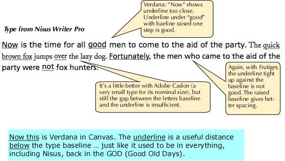

Hello folks
I want to be able to underline a word or two from time to time in e.g. direct mail letters -- and as I could in days of yore, I want the underlined words to stay in the same line as the rest of the text on that line, and I want the line not to interfere with the shape of the letters.
The problem now is that the underline is too close to the letters. It needs to be separated from them by a little bit so it adds emphasis but leaves the letters legible. In the good old days, this happened as in the Canvas sample shown; today it is not happening, as in the NWP sample shown. I can get a decent space under the letters by raising the baseline, but that puts the underlined word out of line.
Elbrecht, I appreciate it is not good typographical practice but it is very useful and works very well for emphasising a few words in something like a direct marketing letter. The trick, of course, is to not overdo it.
Cheers, Geoff

Hmmm -- in the rendering to 72 dpi, the gap between the baseline of the type and the underline in the Canvas example using Verdana has narrowed by half. But you get the picture.
Cheers, Geoff

Re: Underlining still needs to be fixed
Geoff,
Putting forward yet another kludge: if you know you are going to have to underline a word or two in a given document, and you want the extra spacing, could you not simply raise the baseline on the whole of your paragraph, adding in a little extra line height if strictly necessary. Then you have the space between the word and the underline, but you'll still line up with the rest of the text ... set a paragraph style in which the font has a raised baseline?
I was thinking the same thing as a workaround, Mark. But not really pretty!
But back on my Fat Mac, I could do it right!
Cheers, Geoff
