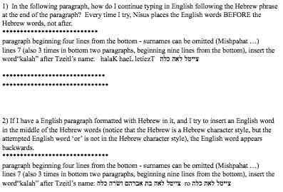

I am having problems with a paragraph in a normal English style with embedded text that is of a Hebrew character style. When the text is at the end of the paragraph, anything I try to type in English after the Hebrew is inserted before the Hebrew, rather than after, and the English appears backwards. Also, if I try to insert an english word in between two Hebrew phrases, the English letters are backwards (and yes, I have made sure that the English word does not have the Hebrew character style).
I have attached a screen shot, but this issue might be easier resolved by private messages. If you think you can resolve the issue and are willing to give me a phone #, I would be happy to call you.

You might try this topic: http://www.nisus.com/forum/viewtopic.php?f=18&t=3130 which addressed this issue recently.

Post by Ruchama »
