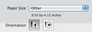

Re: Rotated "Page Setup" doesn't stick
Thanks for the sample file.
rpinsky wrote:When I save with Page Setup as "#10 Envelope," exit and then re-open, the onscreen image looks like an envelope, but the paper time under Page Setup is "Letter."
That's not quite what I'm seeing over here. When I open your file and check the page setup, the paper size itself is correct though not properly labeled/named:
The measurements are correct for a #10 envelope, but the width and height have been swapped and orientation flipped. Is this not what you are seeing? Have your paper measurements actually changed (beyond the confusing swap/flip)?
Well, the settings I observe here effectively produce the same output when making a PDF/printout, but this still looks like a bug. Your paper label/name should not be lost, nor flipped in such a confusing manor. I'll file it as something that needs fixing.
