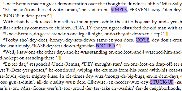

Sorry to harp on, Martin, but there's still the shadow of a bug, I guess.
Words now are correctly selected, but only when followed by punctuation marks or double quote (”), while they are skipped when they are followed by single quote (’), space or return. See the image below.
Picture 2.gif (49.33 KiB) Viewed 13070 times
Thanks, Henry.
Re: Regexp with style definition
Thanks Henry, we'll revisit this; sorry for any trouble it's caused.
