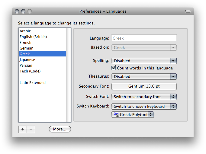

Ninurta wrote:Of course I studied the manual pp. 40-47 but I simply do not understand your description of how to change languages and how to adjust the preferences.
Yeah, it is not very easy to understand. You have to configure the Pref like this for each language you use. If you use more than a single font for a language, it would be convenient to set "Switch Font" to "Switch to last used font".
If you have configured the Languages Pref properly AND if you change languages always from inside NW‌ Pro (NOT via the Flag menu in the System menubar), the problem 3 would not occur, I think.

Thanks a lot for your help!
Changing of languages works now properly (and NOW - afterwards - I understand the manual).
One problem remains (my third point): Reformatting a paragraph to Times New Roman (!) - e.g. to Normal - causes changing of all hebrew and greek characters to Times NR. The effect is that the Hebrew vowals are not placed correctly.
