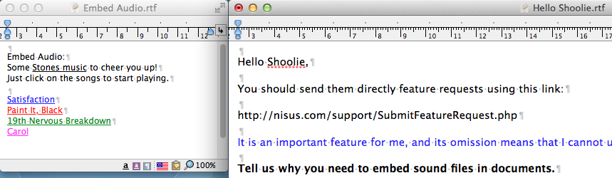

If you are keeping the documents and sound files on the same machine, and by that I mean you don't need to send them to other people, then you can create links to sound and video files directly in Nisus, and you won't notice any difference other than the files will be opened and played in the program you determine in Finder. If, for example, you have told Finder to open .m4a files with VLC Media Player, then clicking on the link in NWP will open the file in VLC Media Player.
To do this you have to
1. Create a sound or video file with a program of your choice
2. Then you select the file in Finder and press Command + c to copy it
3. Now you go to your Nisus document and press Command + v to paste a hot link
The link will have the same name as the original file. If you want another name, you just right-click on the link and select "Edit Link…" and
override the file name by typing whatever text you find appropriate into the "Display text" field, and then click OK.
• You can place links to audio files everywhere in NWP, also into Comments.
• You can copy and paste links from one NWP document to another.
The only thing you have to be aware of is, that if you move the sound/video file, then the old file path in the link will not be valid anymore. So how to deal with that?
If you often use audio comments, then create a special folder for audio files, and keep all your audio comments in there. Don't ever move that folder.
If you do this, then Nisus will always find your audio files, and you won't have any problems.
Here is a scenario that shows how you can play music in NWP:
I. Select one or more music files in Finder
II. Press Command + c, and then paste the links into a Nisus document (I like to paste my music links into a small separate document which I drag around).
III. Save the doc with the music links, so you can use it over and over again.
This gives you much more flexibility than if you had just clicked on the files in Finder and let them be played in VLC.

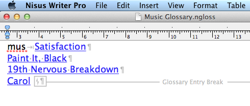

To take this to the next higher level, create a Music glossary file.
Every time I type "mus", Nisus will automatically and instantly paste the following old Rolling Stones titles into my document:
Satisfaction
Paint It Black
19th Nervous Breakdown
Carol
This is how it looks like in the glossary file:
