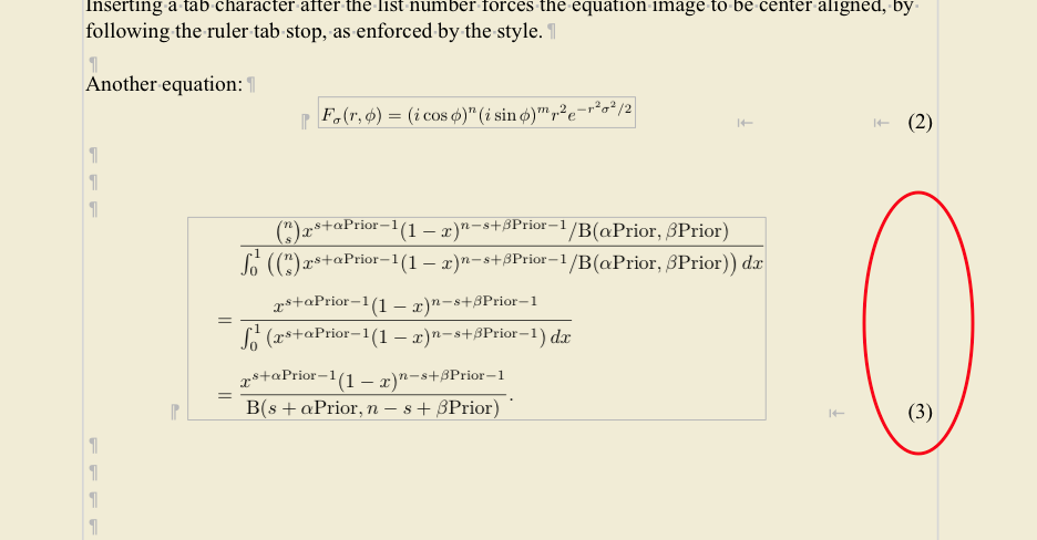

Re: Equation numbering methods.
Martin, ingenious indeed but placing the equation image inline you'll end up with the equation number aligned with the bottom of the image.
The effect is apparent when inserting multiline equations.
Are there any soutions to this problem?
- Screen Shot 2020-10-30 at 11.13.17.png (77.33 KiB) Viewed 22229 times
G'day, johseb et al
If you select an image, its dimensions are shown in the Shape Metrics Palette. Choose the Units to be Points, so you see the Height of the image in points. Now select the list item number and raise the baseline (via the Format menu) by half the number of points in the image's height. I think this will achieve what you want. There's bound to be someone out there who can wrap these steps into a nice little macro.
There's also bound to be a pedant out there who will observe that the sort of thing you have adduced is more in the nature of a set of equations than a single multi-line equation (although it actually has characteristics of both).
So another possible approach is to split the set into separate images and remove the List characteristics (via the Format menu, the Lists Palette or the List icon in the Toolbar) from all but the "middle" graphic. You can use Continue Numbering to have subsequent list items numbered in the same sequence.
Hi Adrian, your method works perfectly. Thanks for the tip!
My example was purposely extreme but I guess the number of a significant proportion of equations will be off-center (even though by a small amount).
The table method automatically takes care of the vertical aligment of the numbers but Martin's method seems more "clean"; as you noticed a macro would be a nice addition.
In any case is good to have a choice.
A more proper solution is certainly still desirable. I think the most complete way to address this is custom numbering sequences that can be placed anywhere in your text.So I think my earlier suggestion of allowing a choice between leading and trailing list item numbers, taking due cognizance of writing direction, would still be preferable.
That's a great idea Adrian! I'll attach such a macro. To use it just place the selection/caret anywhere within the paragraph with the equation image and run the macro. It will detect the image and list item, and adjust the baseline as needed.
The only issue is that the macro must guess how tall the list item is by itself, in order to properly center it. There's a variable for that near the bottom:
$textHeight = 10- Attachments
Equation Image, Align List Item Vertically.nwm- (6.6 KiB) Downloaded 660 times
Nisus Writer Pro version 3.2 improves on this macro by using a new command to measure the list item's height:
$listItemSize = $text.opticalSizeInRange($listItemRange)• Image, Align List Item Vertically
