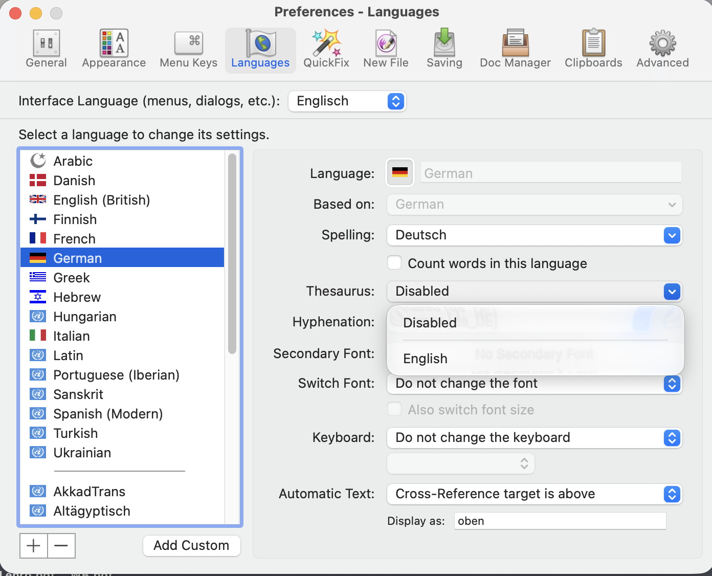

Thank you very much, Adryan, for your suggest. I switched the Interface Language to Automatic. After a restart of Nisus I had a German Interface instead of an English. I tried again a spellchecking of a German document and still had the same problem. Therefore I switched again to an English Interface. During this procedure I discovered, that in my language preferences after "Thesaurus" "Disabled" is selected. I have only one other choice to change that namely "English". There seems no German Thesaurus to exist.
Do you have an idea how to install a German Thesaurus?

The Nisus thesaurus is available only in English (NWP user guide, page 42).
Incidentally, I interpret Adrian as recommending that you set language to Deutsch, not automatic, to facilitate spell checking in Deutsch. But this does not conjure up a Deutsch thesaurus, unfortunately.
