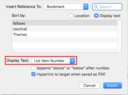

For the scenario you described, I would use Display Text as "List Item Number" instead. That would do exactly what you want to do, as far as I can see. The method is versatile and can be applied in more than one way.
Here is what you can do:
1. Create bookmarks the usual way.
2. Then assign an incremental numbered List Style to the text of the section for which you want to display paragraph numbers. Each paragraph now starts with an incremental number, like this:
1.
2.
3.
etc.
3. Now, when you cross-reference, you get correct paragraph numbers.

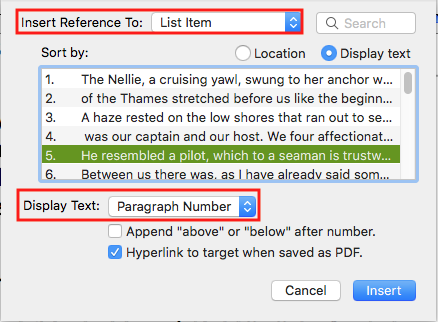

4. If you don't want to see every paragraph start with a number, then open Style Sheet, select the numbered List Style and assign it the Text Color white. That will make the numbers at the beginning of each paragraph invisible, but the numbers in the text body will not be affected.
You can also insert Reference to List Item and have the text be displayed as Paragraph Number.
Instead of displaying text as "Paragraph Number" you can also choose Display Text: List Item Number. Both work fine.
Let me know whether this works for you.
