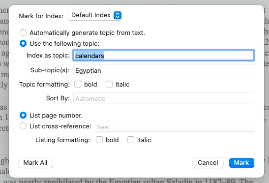

As far as I am aware, you will get exactly this output, if in the location of your document where you discuss "Egyptian calendars" you Index As "calendars" and sub-index as "Egyptian", and so on for all the others. Of course the capitalization is entirely up to you, Nisus will just use the topic names that you type into the box.
Nisus Index-subindex.png (57.36 KiB) Viewed 65521 times
So I guess, this kind of answers the second part of your question. It has to be done manually.
But… Actually the macro language can be used to automate these things, as long as you have some actual system that allows for automatisation. So if you have such a system and would like help with a macro, feel free to let us know, and maybe we can help.

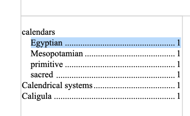

nev wrote: ↑2024-08-05 00:12:45 phspaelti — thank you. Your solution works - mostly: the only thing it doesn't do is indent the subheadings, so I suppose it is 'manual' in that regard, but it's still handy for me.
Index items should have styles applied, which should allow the control of the indent. In my case the Index topics have Index 1 style and the sub-headings Index-2. So in my case they do indeed indent.
Nisus Index.png (16.06 KiB) Viewed 65492 times

phspaelti wrote: ↑2024-08-05 02:10:15 Index items should have styles applied, which should allow the control of the indent. In my case the Index topics have Index 1 style and the sub-headings Index-2. So in my case they do indeed indent.
Yes — I see that applying select styles would be the appropriate way to indent them, thanks.

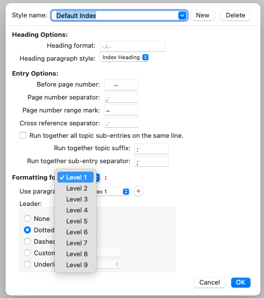

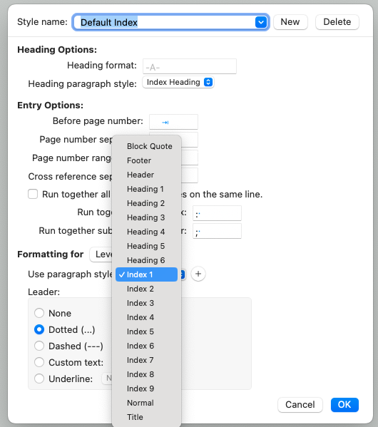

Re: Subject Subheadings in an Index
Styles for the subtopics can be set in the Configure Index Styles dialog.
Configure Index Styles 1.png (103.09 KiB) Viewed 65468 times
Configure Index Styles 2.png (115.4 KiB) Viewed 65468 times
Whatever you choose here should be set automatically.

phspaelti wrote: ↑2024-08-05 06:01:00 Styles for the subtopics can be set in the Configure Index Styles dialog.
Oh that's great! Makes it so easy. Thank you so much for pointing that out to me!
