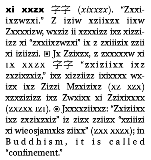

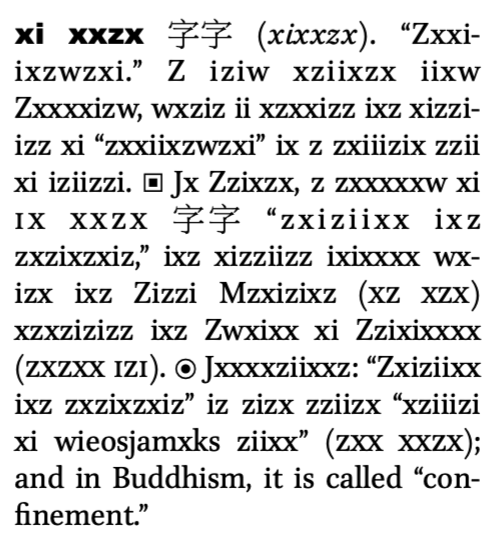

Hello Nisus users,
Below are two screenshots of an entry in a Chinese-English glossary I’m writing. Since I'm writing for a publisher and cannot yet make the contents public, I’ve scrambled most of the entry using the “Redact” macro. Only the last sentence is in plain English and this is where the problem occurs. The last word (“confinement”) is within quotation marks and Nisus does not hyphenate it but moves it to a new line. As a result, the spacing in the previous line is huge.
Strangely, if I add a short word (“and”) in the previous line, “confinement” is correctly hyphenated.
The lines look very short because this is a 2-column page. The whole passage is set in US English and I’ve used both “Automatic-Normal” and “Automatic-More Often”, but the result is the same.
Is there a way to solve this problem? Thanks for any advice.

I wonder if the problem is that "confine- (the other possible hyphenation point) is still too long to fit on the line, hence it can't hyphenate. Putting 'and' in means that the "con- hyphenation point is used. That's just my guess.
You could try inserting a "Soft hyphen" at the 'confine' hyphenation point (Insert > Special Character > Hyphens and Dashes > Soft Hyphen) to see if that will force hyphenation there, or put one in after 'con' to see if it forces hyphenation there. Otherwise, highlight the line and see what you can do with Format > Kern > Tighten by… (if you just select Tighten, it is tightened by "3 twips")

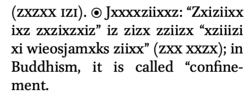

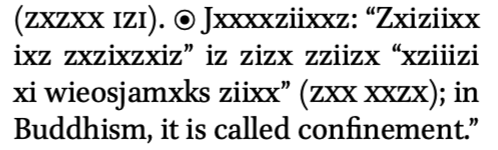

Thanks for your suggestion. Indeed, I can add a soft hyphen after “con” or after “confine” and the word is correctly hyphenated in both cases. However, I’m reluctant to use soft hyphens because they make words not searchable.
I also tried to kern the last two lines. With 1 twip, nothing happens. With 2 twips, the two lines are compressed into one line. In either case, no automatic hyphenation. It’s like “either all or nothing”.
I believe the problem is really with the quotation marks. If I remove the second mark, “confinement” is correctly hyphenated. If instead I remove the first mark, no hyphenation is needed and the last 5 words fit in one line. (See new screenshots below). Looks strange to me, because whether I remove the first or the second mark, the length of the sentence should be the same.

I don't think it's so much a question of where the quotation marks are, as it is of how the particular font handles the associated kerning.
I performed the following experiment: I created two paragraphs, one with your text with the opening quotation mark and the other with your text with the closing one. I dragged the right margin to the left and watched what happened. With almost all fonts, both paragraphs split in unison. However, with STIX Two Text, I observed the same differential splitting you did. Tightening the kerning between the opening quotation mark and the succeeding character, or loosening it between the closing quotation mark and the preceding character, by just a single twip then made both paragraphs split in unison, as it had with the other fonts I tried.
Also, kerning sometimes needs to be done on a space-by-space basis, rather than applied holus-bolus to an entire line.
