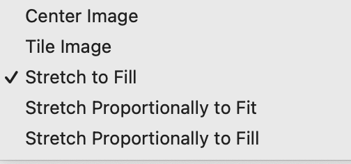

EDIT2: Is there a way to make it so that if I resize the cells (rows & columns), the image will not automatically resize? Probably this has something to do with the drop-down list at the bottom of the Finder-like screen that shows up when "Image From File" is selected. Here is what I see:
Center Image
Tile Image
Stretch to Fill
Stretch Proportionally to Fit
Stretch Proportionally to Fill
Insert File Dialog including %22Stretch to Fill%22.png (22.6 KiB) Viewed 11870 times
After having added the background file image, is there a way to change those settings?

To delete a background image, click on the relevant Cell, then Table > Shading Pattern > None.
As far as I can determine, you can't alter the opacity of a background image inserted as a Shading Pattern in a Table Cell. You can insert an image in a Table Cell via Insert > Image > Insert Image… and then click on the image and alter its opacity via Insert > Image > Opacity. But this image constitutes actual Cell content, not background, so it will be overwritten by any other data you insert in the Cell. The image does not respond to settings in the Shape Wrap Palette. Curiously perhaps, Control-clicking on the opacity-modified image allows you the option of saving it elsewhere, but the saved image is your original opacity-unmodified image.
Nor do I think you can prevent an image inserted (by whatever means) in a Table from being resized along with its containing Cell. I'm not sure how useful such a feature would be anyway. If you want to have a background image of fixed size behind a Table, a Watermark (in the Tools menu) might suit the purpose.
Finally, having added a background file image to a Table Cell, I think the only things you can do with it are alter its size (by altering the size of its containing Cell) or delete it.
These are the results of my investigations anyway. Someone else may find one or more workarounds.
