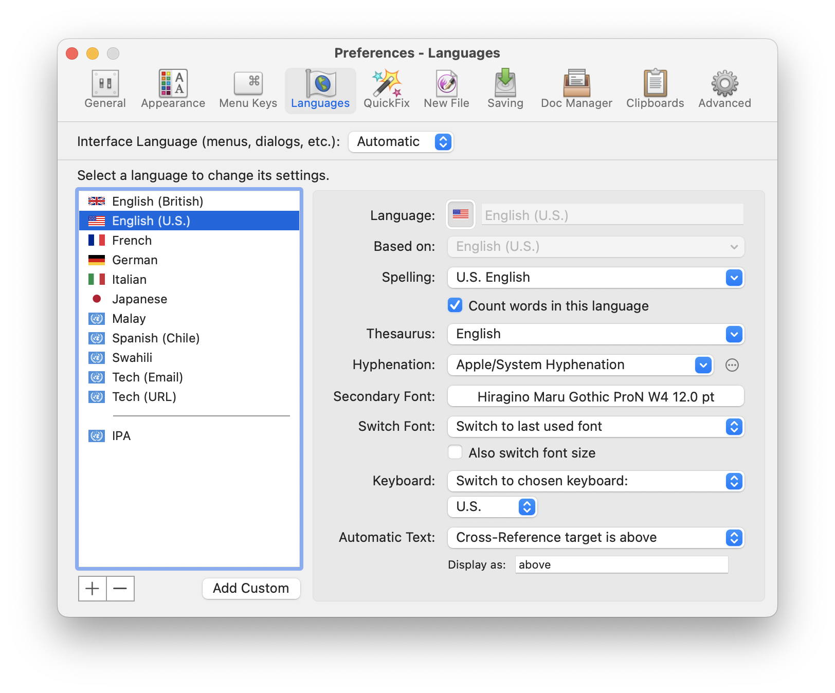

My requirement is that I use a font that does not have Hiragana, and from time to time I need them. I have a Hiragana font installed. My expectation is that I should be able to set the Hiragana font as the 'secondary font' in settings.
The behaviour I am seeing is that in settings, appearance there is a 'Secondary Font' button. I can click it and get the system font pane. I can select any font in this pane, but I am unable to have it be selected.

I just tried this, and this is what it looks like for me: As far as I can tell it works. If I have some Japanese in my English text it uses the Secondary Font selected to display the Japanese.

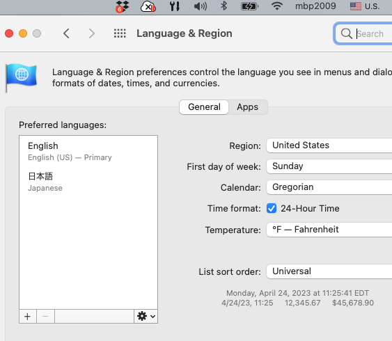

If I understand correctly, you are writing an English (or other Western) language document using, e.g., Courier, and now and then you need to type and display ひらがな hiragana.
I don't know anything about 'alternate fonts', but to get Japanese (hiragana, katakana, kanji) in a document, you only need to have Japanese enabled as a Preferred language in the Language and Region system settings panel. When you want to input hiragana, simply change the Language setting in the system pull-down menu to Japanese:Hiragana, and type away. ひらがな will display correctly in Courier, etc. I toggle between Japanese and English by hitting cmd-space bar. If you want the J to be in a particular font, that can be done globally when you're done, or by some simple macros.
I use the following called by cmd-JJ to switch to Japanese. A similar one goes back to English.
# SetJapaneseFont
Format:Language:Japanese
Format:Font:All Fonts:ヒラギノ明朝 ProN
[img][attachment=0]Screen Shot 2023-04-24 at 11.47.17.png[/attachment][/img]
Cliff
# SetJapaneseFont
Cliff
- Screen Shot 2023-04-24 at 11.47.17.png (68.71 KiB) Viewed 13998 times

Character styles are a good option. But I'd like to try to clarify your problem if possible. Maybe we can still help you solve it.
When you say you "cannot set that secondary font" it sounds like you can't edit the setting in the first place. You haven't even reached the concern of whether or not it works correctly for your document text. If that's correct, let's walk through how you're changing the setting. The process should go something like this:
1. Open Nisus Writer's language preference pane and choose the desired language, e.g. Japanese.
2. Look for the "Secondary Font" setting and click the "No Secondary Font" button.
→ Apple's system font panel appears
3. Select a font in the system font panel, e.g. in the "All Fonts" collection, click the font family Hiragino Mincho ProN.
→ The secondary font setting in Nisus Writer's preference should update to match the font you selected.
4. Close the system font panel.
Is that what you're doing? If so, what exactly goes wrong? What happens when you choose a font in step 3?
Re: Switch to secondary font
It previously failed at Step 3, but now works.
Thanks.
