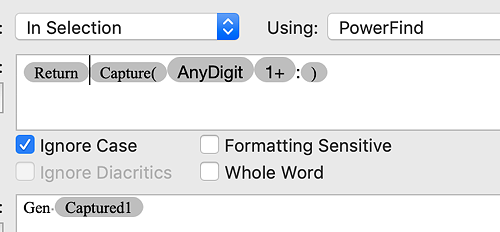

The text is already typed in. I want to find like this (using PowerFind):
PowerFind search. Range: "In Selection". Typed in "Gen"
Screen Shot 2022-11-19 at 17.56.53_500.png (28.49 KiB) Viewed 15168 times
Issues with this:
(1) Rather than have to change the "Replace" field to "Gen" or whatever other abbreviation each time, I'd like the macro to throw up a dialog for me to type in the abbreviation (depending on what file/section I've selected). For each selection it would only ask for the abbreviation once.
(2) I would like it to handle returns and soft returns. (I don't know how to tell PowerFind to find either a return or a soft return.)
