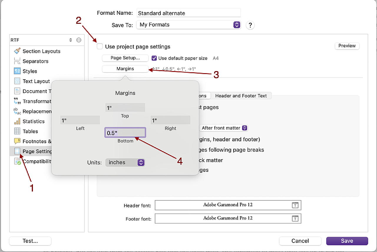

To continue… :)
I've been playing around with a project that has Section breaks, using two different Compile formats to RTF, and in neither of them is there any difference in the footers in the different sections. I tried it with both the default 1 inch margins all round, and also with the footer margin changed to 0.5 inch … in neither case did I get a variation in footer height.
If you want to change the margins in Scrivener, you need to edit the Compile format Page settings, though I would presume you've already tried that.
Screenshot 2022-08-08 at 14.21.jpg (116.66 KiB) Viewed 117237 times
As I say, info about your project and compile settings would be a great help. You could PM me here or on the Scrivener forum (same handle on both!)

These are the settings I have for my Scriv defaults. The Nisus page is A4 with 1" margins all round. I normally have a gutter of 0" with the header and footers at 0.5". I think it might be the different header/footer on first pages that's making the difference. It's trivial to do the find/replace etc and a global page setting but I can't see what in Scriv is causing the problem.

Hi Mark:
Thanks for the image of your Scriv settings which made me take another look at mine.
As a result I've modified them to uncheck "use project settings" and then reset the margins to match those in Nisus. Now if I do compile the Scriv project, the footers and headers are consistent throughout the sections in the compiled doc when it is opened in Nisus.
Why this should ever have been a problem will remain a mystery - at least to me. The number of years I've used both Nisus and Scriv and I'm still learning.
