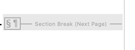

Thaks for the reply Phillip. I thought that might be the case. At present the section breaks look like this:
![Image]()
The search command for these in Powerfind Pro, I think is: \f If I do "find/replace" those with (say) xx$xx (anything unique) it removes the sections. Do a global set footer height and then do the reverse replacing the xx$xx with section breaks that seems to work without messing up the formatting too badly.
The only thing I did notice is that despite using \f the replacements are page breaks and not "Section Break (Next Page)" as per the original. At this stage of the project it makes little difference, but I can't see a reason why it should be so.

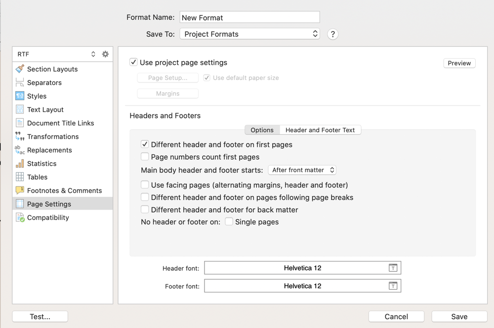

Hi @Tacitus,
I wrote a reply earlier in the thread, but it took me so long to write it that it was redundant by the time I'd posted it.
I don't think I've ever encountered your footer problem with Scrivener --> NWP, but I'll have a shufti. Any information you can give me about your Scriv project and Compile set-ups will make it easier to work out what might be going on at the Scrivener end.
Re: Replace character style
To continue…
I've been playing around with a project that has Section breaks, using two different Compile formats to RTF, and in neither of them is there any difference in the footers in the different sections. I tried it with both the default 1 inch margins all round, and also with the footer margin changed to 0.5 inch … in neither case did I get a variation in footer height.
If you want to change the margins in Scrivener, you need to edit the Compile format Page settings, though I would presume you've already tried that.
As I say, info about your project and compile settings would be a great help. You could PM me here or on the Scrivener forum (same handle on both!)

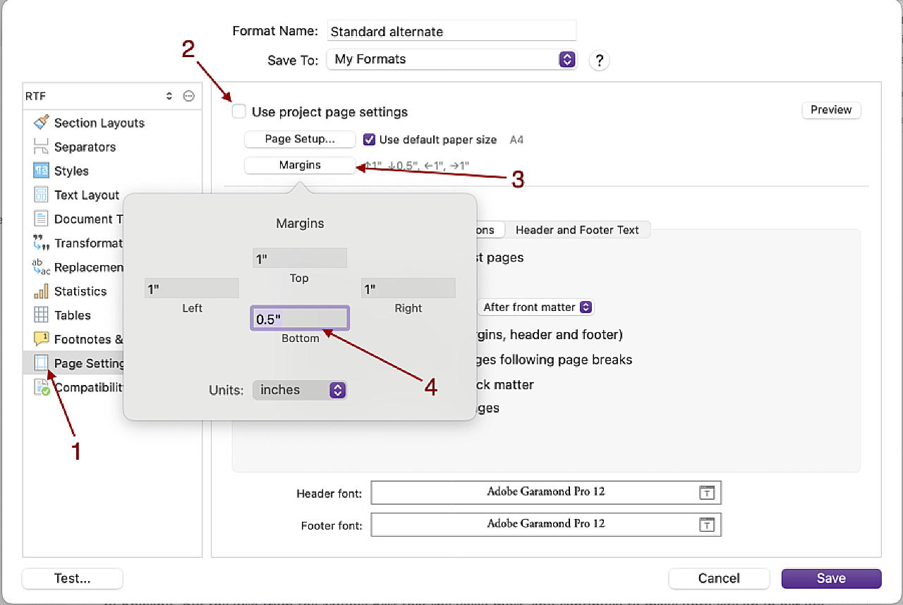

These are the settings I have for my Scriv defaults. The Nisus page is A4 with 1" margins all round. I normally have a gutter of 0" with the header and footers at 0.5". I think it might be the different header/footer on first pages that's making the difference. It's trivial to do the find/replace etc and a global page setting but I can't see what in Scriv is causing the problem.

The problem is basically that "\f" (= "\x0C") is the generic character used for all breaks, i,e., all types of section breaks as well as page breaks, column breaks, and probably glossary entry separators as well. Nisus distinguishes them using the formatting.Tacitus wrote: ↑2022-08-08 00:30:26 The search command for these in Powerfind Pro, I think is: \f If I do "find/replace" those with (say) xx$xx (anything unique) it removes the sections. Do a global set footer height and then do the reverse replacing the xx$xx with section breaks that seems to work without messing up the formatting too badly.
While one can probably get the desired results using format sensitive replace, I would opt for a macro language solution like this:
# Replace All Section Breaks
$doc = Document.active
$breakSels = $doc.text.find "\x0C", 'a'
foreach $sel in $breakSels
$type = $sel.text.breakTypeAtIndex $sel.location
if $type == 'section'
$doc.setSelection $sel
Section Break:Next Page
end
end
Note also that you can also regularize the section formatting without the need for any macro. Just select the whole document, and adjust the formatting in the Sections palette. (NB: You will need to type specific numers in the boxes and then press "enter" for this to have any effect.)
Hi Mark:
Thanks for the image of your Scriv settings which made me take another look at mine.
As a result I've modified them to uncheck "use project settings" and then reset the margins to match those in Nisus. Now if I do compile the Scriv project, the footers and headers are consistent throughout the sections in the compiled doc when it is opened in Nisus.
Why this should ever have been a problem will remain a mystery - at least to me. The number of years I've used both Nisus and Scriv and I'm still learning.
Thanks to all for the help.
