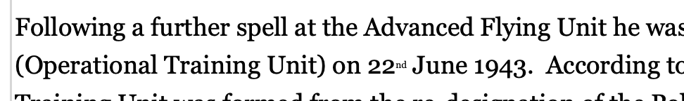

I use Scrivener as my writing tool for long form projects and then transfer to Nisus. When typing dates Scriv uses ordinals EG 20th/ 23rd etc. The 'th' and 'rd' are put in 8pt superscript, and in Nisus this translates the same although sometimes with a baseline the same as the body type. In Nisus this becomes:
Screenshot 2022-04-10 at 10.13.33.png (31.66 KiB) Viewed 221359 times
TBH I'm not sure how books treat date ordinals. Those I've looked at appear to my eyes to use superscript but possibly with a slightly smaller type to that of the main body text, so any advice appreciated. To me 8pt looks rather too small.
Is it possible to devise a macro which looks in the body text for any 8pt text (plain or superscript) and alters this to (say) 12pt superscript, perhaps with a baseline of -1, although I'm happy to take advice from any typography experts on here. I did think the latter part could be achieved with a character style, but this style would be plain text and the problem appears in both italic and normal text. Ideally the macro would take account of the surrounding text - plain or italic - and adjust accordingly.
Footnotes are generally 9 or 10pt text so the only place 8pt appears is in the body with those characters which transferred from Scrivener.
I suspect this may be more trouble than it's worth. I'm not a purist regarding typography and if neccessary could turn off the ordinals for dates in Scrivener, but it would be nice to retain them in the final Nisus output.

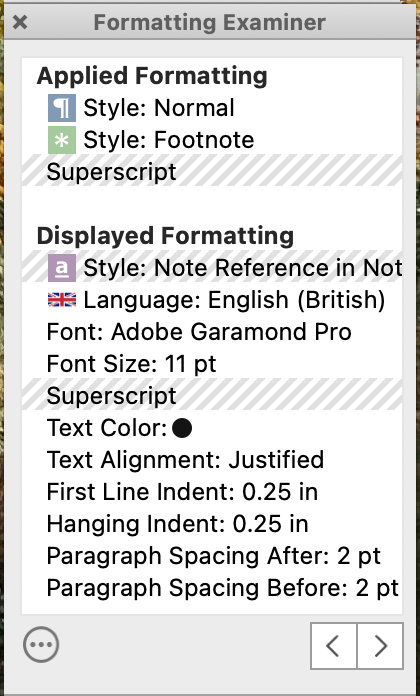

The thing is, in Scrivener footnotes/endnotes are "No Style". When compiled to RTF and opened in NWP, if you put your cursor in a footnote and look at the Formatting inspector, you will see it is assigned "Normal" paragraph style together with "Footnote" and "Superscript" (You need to Cmd-A to select the entire footnote to see the latter). This means that they do not fit the style as defined in the style sheet — in my case a hanging indent of 0.25 inches, with the "Note Reference" not superscripted and followed by a tab.
Screenshot 2022-04-16 at 23.18.14.png (112.98 KiB) Viewed 220599 times
Fortunately, it is easy to resolve … with your cursor in a footnote:
  • Cmd-A to select all that footnote;
  • Cmd-A again to select all footnotes;
  • Right-click on "Style Normal" and from the dropdown choose "Remove Selected Formatting";
  • If you don’t want the Note Reference superscripted, right click on "Superscript" and choose "Remove selected Formatting".
And that's it. All your footnotes should now conform to your settings in the style sheet. Some macro-wizard might be able to produce a macro to do that, but it's a minimal amount of effort needed to sort out all your footnotes at one go.
