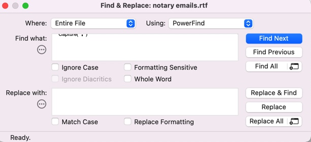

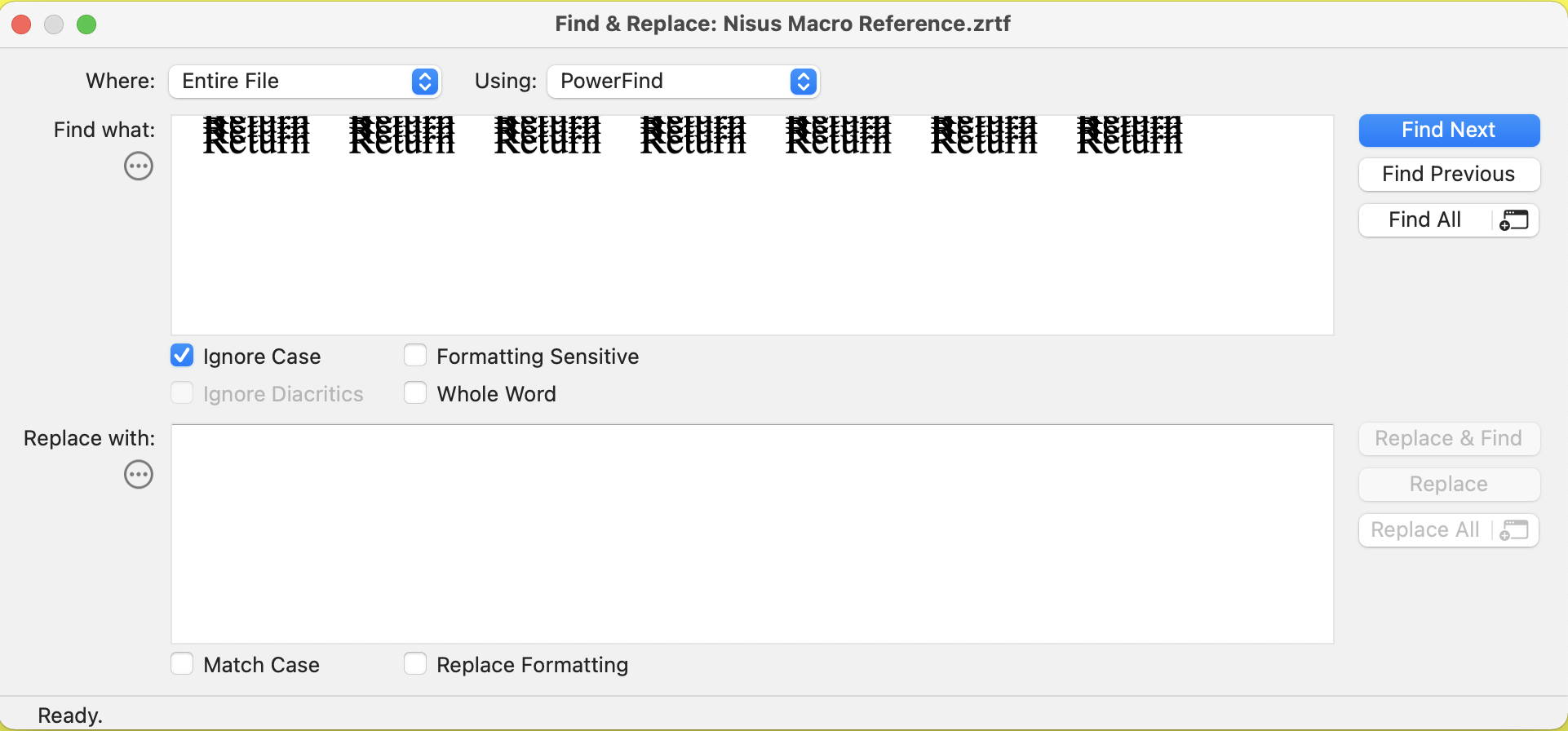

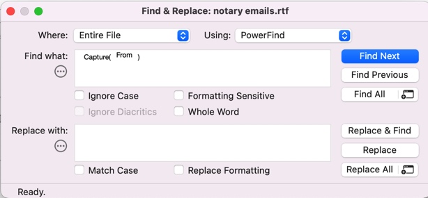

In Find and Replace when I enter a command such as "Capture()", it is superscripted and partly disappears upwards, but as soon as I type a character, it then moves down. Here are some screens to show the effect:
Find & Replace 3.jpg (51.75 KiB) Viewed 17162 times
Find & Replace 2.jpg (50.06 KiB) Viewed 17162 times
Find & Replace 1.jpg (69.66 KiB) Viewed 17162 times
Is there a way of avoiding this?

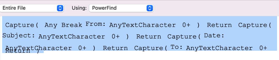

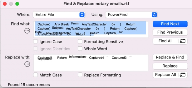

I tried changing zoom, fonts, paragraph spacing. And the size of the Find and Replace window. They do make some difference but still get things such as:
CleanShot 2022-03-24 at 11.22.26@2x.jpg (82.33 KiB) Viewed 17117 times
I hope the developer can fix this.

To explain a bit more clearly what I meant:
The Powerfind "Bubbles" -- capture symbols, repeat symbols, wildcards, etc. -- do not seem to have any line height. If your expression consists only of such bubbles then they will slip above the limit of the find box (as in your second image). If your find expression extends over multiple lines, any line which contains only bubbles will overlap with the previous line.
This aspect can be "fixed" if you set the paragraph spacing to fixed line height and give the line height a reasonable size. Obviously this will only work if you are not using "Formatting Sensitive" Find.
You can also "fix" it by adding an actual text character on the line of the find expression, but if that character is not part of the expression, you will need to remove it again.
A second problem is that text characters and bubbles do not align on the text line. This is why the "From:" appears higher than the "Capture()". This could be seen as a "feature", as it gives a visual cue for the difference. Personally I preferred the old system where the bubbles actually looked different and had some visual indication of bubblehood. I think if would be nice if Nisus could add preferences for this.

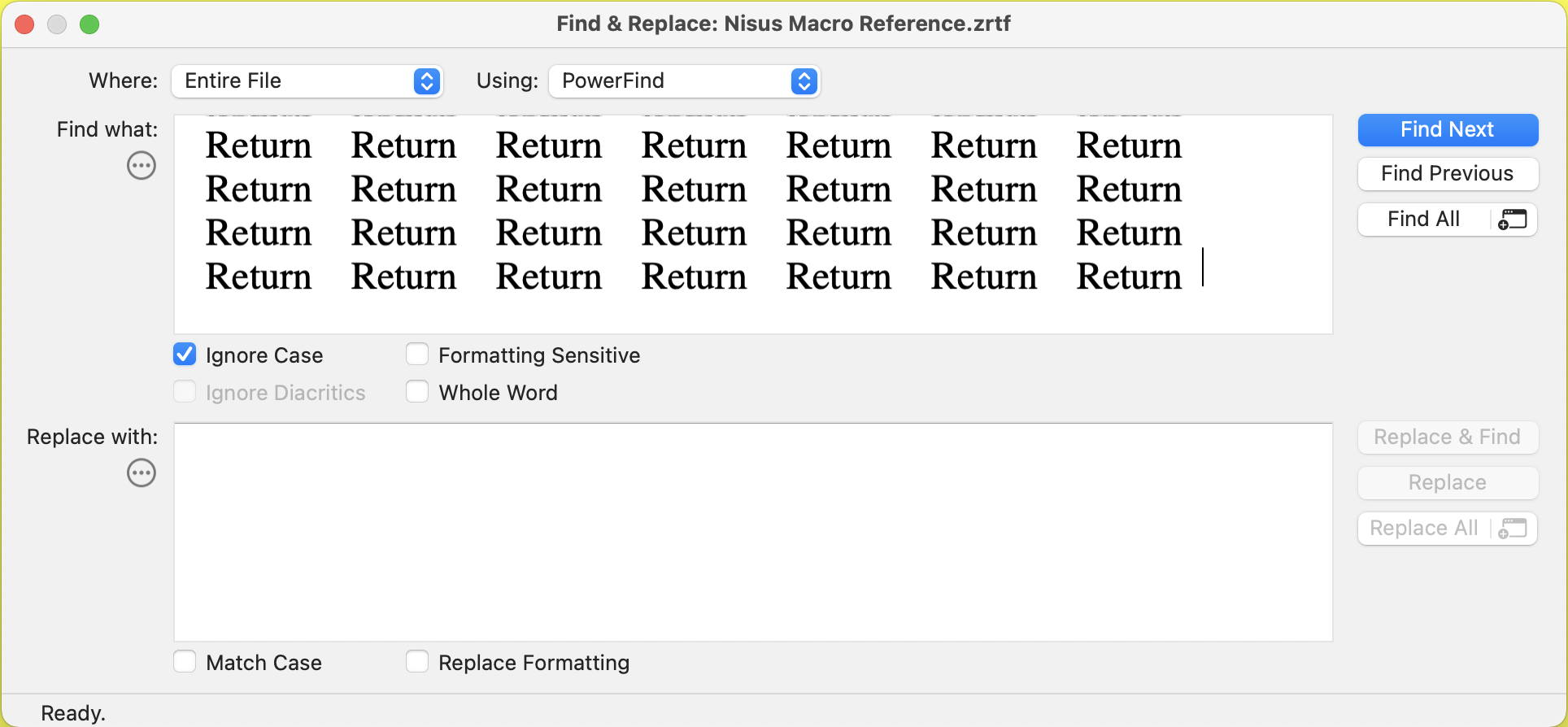

Just to illustrate with screen shots:
Here an expression consisting only of repetitions of the Return Special Character. Here I set the line height to fixed 18pt
Find Dialog 2.jpg (147.39 KiB) Viewed 17107 times
And here the same with automatic line height
Find Dialog.jpg (122.92 KiB) Viewed 17107 times
