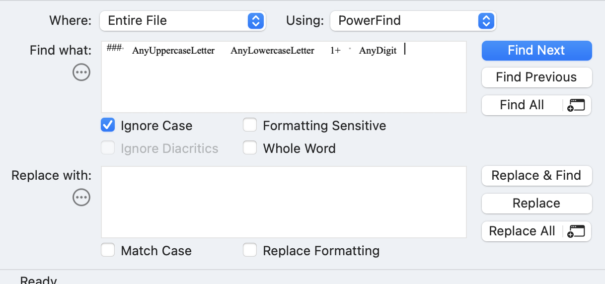

Thank you also, Martin, for the link to Regular-Expressions.info. I have bookmarked it so I can spend time going over it, and returning to it when necessary. I have also bookmarked regex101.com as it allows you to build, test and debug a regex you're creating. But, actually for someone who is just beginning to dip their toes into the RegEx water, it tells you at what point your expression fails, but not why. So the best tutor I've found is NWP … create your expression in PowerFind — as even with the current display problems on Monterey
Screenshot 2022-03-12 at 18.45.42.png (119.55 KiB) Viewed 7935 times
it is more readable for the novice than a string of arcane metacharacters — then convert it to Powerfind Pro to see the full expression.
