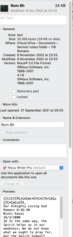

Dear all, I opened some old Nisus rtf files that were japanese and English text but the Japanese is mojibake ie illegible like thisøÇÕímǡǃǢNjÇ∑ÅB
Anyway to make this legible? TIA

I think you're right. These were from 2000-2002 and have black icon. There used to be a old app called Kanjitext which would do the job but it has long since ceased to function.

The info box says 'Nisus® 3.0 File Format'

[attachment=0]Screenshot 2021-09-21 at 05.35.09.png[/attachment]

Is there any formatting at all in the file when you open it in Nisus Writer? That is, does your text have different fonts, colors, graphics, or anything like that? If not, then your file lost its resource fork as explained in the FAQ.
If your text uses standardized legacy text encodings from the OS 9 days, then it's possible there's an app that can help you convert it, but I'm not familiar with any, sorry. I can only recommend you craft a conversion macro as mentioned in the FAQ.
The best outcome with old files is to archive your original data files before transferring them to a modern Mac, so that Nisus Writer can import the full data with resource forks intact. That may allow automatic conversion of your old text.

Thanks for your reply. Yes the old file does have different fonts, colors etc. Unfortunately that old Mac has long gone.

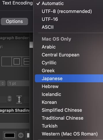

Mojibake appears because the app cannot detect in which legacy text enoding the old file was saved.
You can try the following to help NWP apply the correct legacy encoding to open the old file:
Make a duplicate of your file in the Finder and add .txt file extension to the file.
Then in the NWP Open dialog selct the file.
When the file has .txt extension, in NWP Open dialog, you can select Japanese from the Text Encoding drop down menu to open the file in the legacy encoding.
I hope this works to recover the text at least.

Re: Old files are mojibake
Brilliant. Thanks it works!
