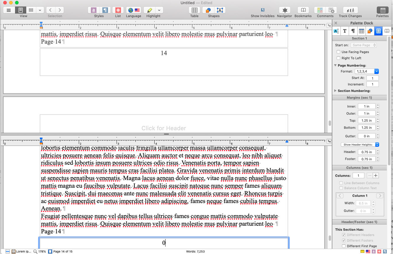

So here's a screenshot of what I'm seeing. As you can see, page 14 shows the correct number in the top split but zero on the bottom. I've also seen behavior where the bottom split mirrors the top split's page number, regardless of what page the bottom split is showing. I've sent some documents to Martin as well.
I'm not sure, but maybe having more than one section in the document causes issues? Or having different page number formats for part of it--e.g., like lowercase roman for introductory and regular arabic numbers for main body?
