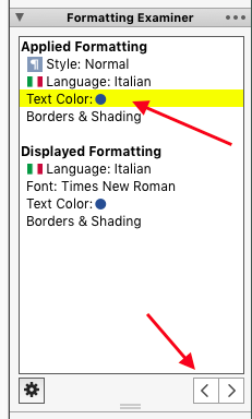

Have you tried the Formatting Examiner palette? The FE is one of the most useful and flexible additions in NWP3.
You just have to select the attribute (blue text color in your case) and use the arrows.
Screen Shot 2021-01-09 at 01.30.10.png (25.69 KiB) Viewed 37715 times
