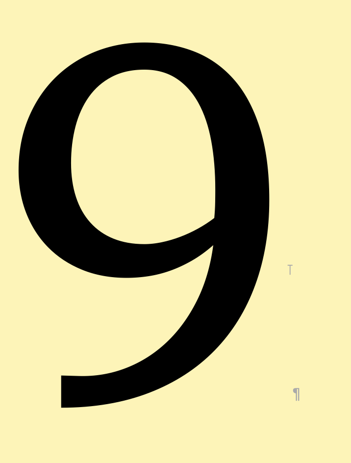

I found a mysterious Control Character in a Nisus document:
After the digit 9 there is a unvisible character with no width represented by a small T before the return.
Does anybody know what it stands for? What does it do? How did I insert it? Can I search for it? Can I delete it without causing trouble?

The character code says it's #202C which Unicode explains as "POP DIRECTIONAL FORMATTING".
I'm pretty sure you can delete it, if you don't need it.

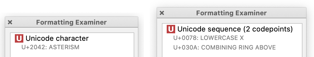

Re: Mysterious Control Character
The Formatting Examiner palette is definitely the best tool for this job. Any time you select a single character (or a single composed character sequence) the palette will show you the relevant information:
You can see both the character name and code (aka Unicode code point).
The palette can also help you find other occurrences of the selected character in your document. Click the left/right arrow buttons in the palette to find and select the next/previous matching character, or click the gear button and choose a find command from the contextual menu, eg: Find All in New Window.

While the question has obviously been well answered by now, I did want to answer one point.
adryan wrote: ↑2020-10-21 03:41:28 When I do that, the character is replaced by "\x".
I'm pretty sure you are not looking at the result correctly. Ulrich's character was in a gigantic font so it was hard to see. But what you get when you use the command is \x{202C}
You can also use the command :to Unicode Character Names in which case you get \N{POP DIRECTIONAL FORMATTING}.

Posts: 626
G'day, Philip et al
Yes, you're quite right, Philip. With that hint about the font size, I now see that it was set at 256 pt in Ulrich's document. As the font size is reduced, progressively more of the code string appears. At 256 pt, anything beyond the "\x" extended beyond the right margin and hence was invisible to me.
