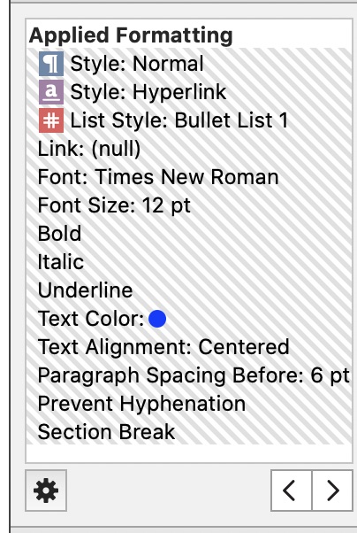

I download a series of court judgements each which contain some applied formatting.
I know it is possible to remove all of it, and also individual elements of the applied formatting.
What I would like to do is to create a macro which removes only some individual elements and one style.
For example in the following:
Screenshot 2020-08-26 at 14.55.16.jpg (86.98 KiB) Viewed 13904 times
after selecting all, I would like to remove the Text Color, Underline, Paragraph Spacing Before formatting and the Style: Hyperlink
(Some of the applied formatting varies from judgement to judgement, for example the Text Color is red or blue)
Is this possible?

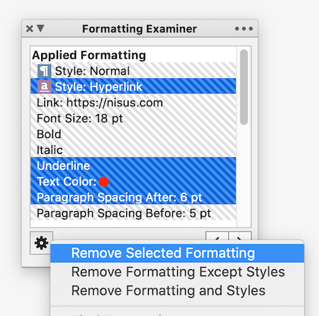

phspaelti wrote: ↑2020-08-26 07:58:19 Then you say you want to "remove the text color".Of course there always has to be some text color. I guess most people consider "black" the default. The command Set Text Color requires a color argument. I can't see a way to say "none".
Instead of using these "Set" commands, it's probably better to work via menu commands like:
Remove Text Color Formatting
Remove Underline Formatting
That won't apply a value (eg: black coloring) that overrides styles. It will only remove preexisting formatting. I think the only problem is that there's no such command for removing paragraph spacing like vwnisus wants. There's only "Remove Paragraph Formatting", which removes all paragraph formatting at once.
However, the original goal doesn't require a macro. The Formatting Examiner palette will let you pick and choose which applied formatting to remove:
1. Select all the text in your document.
2. Click the Formatting Examiner palette's listing to select a single formatting attribute (eg: Underline).
3. Hold down the Command key and click other listed formatting attributes to add them to the selection.
4. Once you've selected all the desired formatting, click the gear icon button to show the popup menu.
5. Choose the command "Remove Selected Formatting" from the popup menu.
