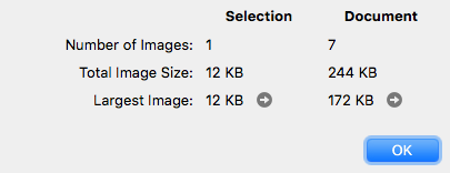

The quickest way to check for large images is to use the menu File > Image Analysis. It will show you this summary information:
You can see the total size of all images in your document. If you want to cleanup your large images I recommend that you click the arrow next to the label "Largest Image". It will open a list of all images sorted from largest to smallest:
You can then click each entry in the list to see the image in the document.

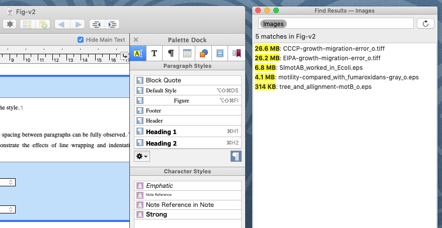

スクリーンショット 2019-01-07 18.33.23.png (148.64 KiB) Viewed 12882 times
I can find 5 images in Fig-v2.rtf and the total size should be '26.6 + 26.2 + 6.8 + 4.1 + 314 = 64 MB'.

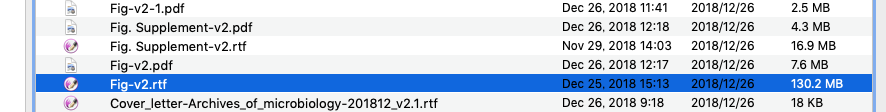

However,
スクリーンショット 2019-01-07 18.35.19.png (40.52 KiB) Viewed 12882 times
130.2MB...
This file only includes images.
It looks like the data become double.
Is there any good solutions?
Re: How to cleanup a history stored file
As explained in the FAQ on image sizes it is not unexpected to see a file size that's about twice as large as all images. The FAQ goes into detail about this, but basically RTF is inefficient. The quickest solution is to switch to a file format like Nisus Compressed RTF (aka ZRTF).
Oh, one other tip: I see your images are using the TIFF file format. That's a lossless image format that tends to use a lot of space. Can you switch to a different image format?
