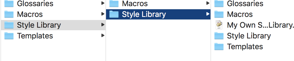

Thank you Martin for the advice. I did so and the result is not so bad.I had NOT to redefine the settings Nisus kept all of my sales and template from before. I just got the same old template according to my own settings, then, instead of trying to get the perfection, I am willing to accept to have to click first in the header once before e I use the main part of the file for writing. I am not sure the presence of templates within the style library is still ok, like this, but I hope the app will do the job.

G’day, Martin et al
But Yohanan still does not have the correct hierarchical folder structure in the Nisus Documents folder.
Re: Install
That's certainly true. There's a lot of unnecessary redundancy and nesting showing in Yohanan's screenshot. It could use some cleaning up, to avoid any potential confusion.
But a messy support file hierarchy isn't necessarily anything to worry about, so long as things are working correctly.
