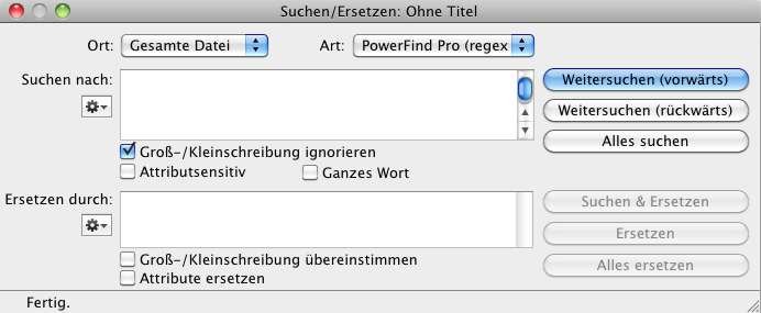

Orientalist wrote:4. in "edit" (I have in German: Bearbeiten) i clicked: find&replace (Suchen /Ersetzen)
5. The answer is a noise from the computer but the window does not appear
Did you set the find mode to PowerFind Pro? In the German localization, this option is labelled "Art". Also, did you type the find/replace expressions exactly as you see in the screenshot I took?
where is this "Art."? I open: "Edit" (Bearbeiten) and then Find/Replace but this step does not open the window you have sent.
I can not type the expressions, because I have not the window Find/replace (Suchen und Ersetzen) So I can not change there PowerFind Pro.

Orientalist wrote:where is this "Art."? I open: "Edit" (Bearbeiten) and then Find/Replace but this step does not open the window you have sent.
This is what the German Find & Replace window looks like on my computer:
You can see "Art" near the top, on the right side. In the screenshot you can see it is set to "PowerFind Pro (regex)".
