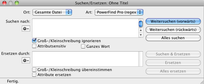

Did you set the find mode to PowerFind Pro? In the German localization, this option is labelled "Art". Also, did you type the find/replace expressions exactly as you see in the screenshot I took?

Orientalist wrote:where is this "Art."? I open: "Edit" (Bearbeiten) and then Find/Replace but this step does not open the window you have sent.
I can not type the expressions, because I have not the window Find/replace (Suchen und Ersetzen) So I can not change there PowerFind Pro.
This is what the German Find & Replace window looks like on my computer:
You can see "Art" near the top, on the right side. In the screenshot you can see it is set to "PowerFind Pro (regex)".

Now I can open the window find/Replace, if I use apple+ F ! I tried to open the window some lines below that where it is written: find/replace. It did not work of course.
