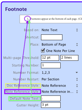

Eric, do you have both Note Reference and Footnote Reference? There is no problem but that is a bit strange.
Open a new document, switch to Style Sheet view, and look at Footnote or Endnote under Note Styles. There, you will find Doc Reference Style and Note Reference Style. The former defines note references in the main body and are usually superscript numbers such as ¹, ², ³… The latter defines note references preceding note text in the notes area, for which some people use normal — i.e. non-superscript — numbers 1, 2, 3… and other people prefer superscript numbers ¹, ², ³… Different from the automatically applied Footnote and Endnote styles, you can choose any character style for Doc Reference Style and Note Reference Style.
In the earliest versions of NWP, both Doc Reference Style and Note Reference Style in Footnote had Footnote Reference by default — i.e. if you use the automatically generated Nisus New File.dot without modification — and those in Endnote had Endnote Reference by default, as you see in the style sheet of Nisus Macro Reference.zrtf (Help:Macro Language Reference).
In the latest NWP 1.4.1, Doc Reference Style has Note Reference in both Footnote and Endnote, and Note Reference Style has Note Reference in Note in both of them, like in the style sheet of Release Notes.zrtf (Help:Release Notes).
So presumably you, Eric, copied and pasted Footnote Reference from another document intentionally or accidentally while you were configuring Nisus New File.dot. And you, Henry, do not have Note Reference because you are a long time NWP user and continuing to use Nisus New File.dot customized years ago without modifying it a lot as far as note related styles are concerned, I guess.
There were some intermediate stages but I don’t remember well.
Anyway, the essential is…
• If you want footnote references to look differently from endnote references, you need different character styles for each of them, e.g. Footnote Reference and Endnote Reference.
• If you want footnote references and endnote references to look the same, using the same character style — e.g. Note Reference — for both of them would make your life simpler.
• The same way of thinking applies to footnote references and endnote references in the notes area.
As Henry explained, what I mean by “look differently” and “look the same” is not the difference or the sameless of Number Format — e.g. 1, 2, 3…, a, b, c…, i, ii, iii… — for which an option is available in Footnote and Endnote, but superscript vs non-superscript, different or same colour(s), font(s), font size(s), etc. Also Default Note Text refers to the text between a note reference and note text in the notes area, ‘. ’ (a full stop followed by a no-break space) in NWP 1.4.1’s built-in Nisus New File.dot. It will be added automatically when you insert a footnote or an endnote manually.

Thanks, Henry and Kino. With your help I may be getting this sorted out. I got rid of the "note reference" style altogether and set my "footnote" and "endnote" styles up so that both use "footnote reference" as the "doc reference" style and "note reference in note" as the "note reference" style.
I was not even aware of the "doc reference" and "note reference" styles before. I guess because, while they exist, and are referenced in the "footnote" and "endnote" styles, they do not appear in either styles lists, i.e., in style sheet view or the styles palette.
It took me a while, but your references to the manual and your explanations were very helpful. My style set is now even simpler, and I think I have at least a clue what things do and how they're relate to each other.
