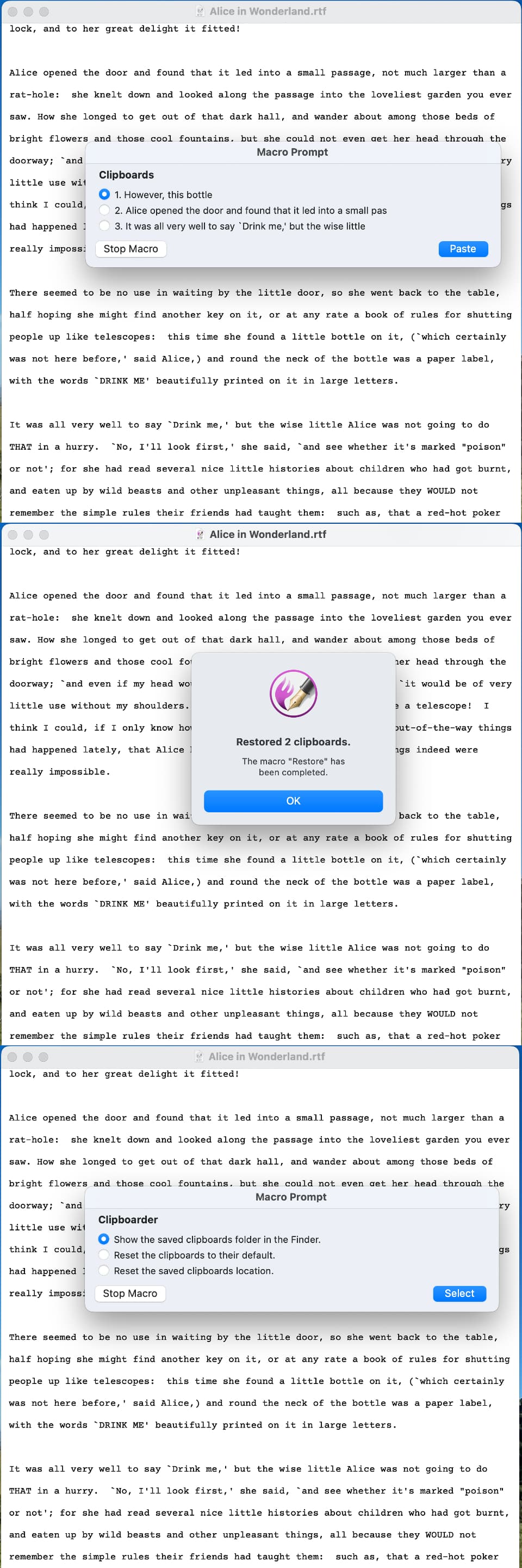

You know how you're writing along, you come up with a good paragraph but it just doesn't fit where you're working. You ever wish you could place it on a scratch pad to use later? If this is you, you're going to love this set of tools.
This set of macros will cut and copy your text selections to the next available Nisus Writer clipboard numbered two and above. It also saves the selected text to a folder given the same name as the title of your file in a folder of your choosing.
This was significantly improved thanks to the help from people on the forum. The latest version uploaded 7 June, 2023
Huge thanks to:
@adryan Adrian—took your advice and now the paste window only shows available clipboards rather than EMPTY CLIPBOARD.
@xiamenese Mark your testing was super helpful.
@martin Martin tanks for the registry code and the choose folder code.
Clipboarder>Paste gives you the option choose the text snippet to paste.
Clipboarder>Paste with no file open offers the choice to reset your clipboards to factory default or navigate to the Save Clipboards folder for housekeeping.
Clipboarder>Restore looks for the folder with the same name as the title of your file to import the saved clipboards so you can paste them as need.
Clipboarder Macro + Manual.zip
(42.45 KiB) Downloaded 1258 times

I like the way this is heading, as it makes the contents of multiple Clipboards more readily explicit than the inbuilt Clipboards Palette.
However, it failed to create a Save Clipboards folder for me. I couldn't find one, and the Restore Macro says there are no Clipboards to restore.
Also, the Copy command skips over an "EMPTY CLIPBOARD" and writes to the next one if it can.
I guess ideally there would also be a Clear Macro that would offer the option to clear a selected Clipboard or the whole lot.
Thanks for creating a nice addition to Nisus Writer's toolbox.

Not sure what you mean by the skipping the EMPTY CLIPBOARD but this may clear things up: The first clipboard is left untouched because it's used system wide. I didn't want to trample on a user's text if they copied from another app. As such, the macro uses clipboard 2 and above. The words EMPTY CLIPBOARD are put in at the time of building the list. If the primary clipboard is empty, it's indicated as such. Let me know if that makes sense. Thanks!
I've updated the zip file with a PDF manual.
Lou
