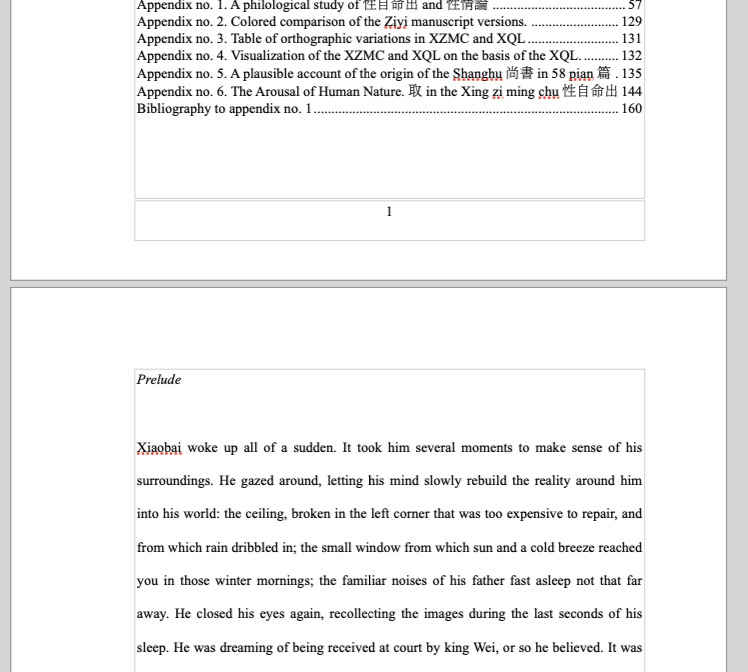

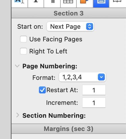

Thank you for this. Here is how it looks for me:
Screen Shot 2022-03-11 at 7.45.31 PM.png (57.43 KiB) Viewed 13027 times
There is a page break bw the end of the table of content and the Beginning of prelude, but the page number starts at 1 with the table of content. Does it work only with section breaks?
Screen Shot 2022-03-11 at 7.46.07 PM.png (119.23 KiB) Viewed 13027 times
I will take a look at macros, thank you for that.
Re: Page numbers and sections
madpoli wrote: ↑2022-03-11 16:47:10There is a page break bw the end of the table of content and the Beginning of prelude, but the page number starts at 1 with the table of content. Does it work only with section breaks?
That's correct. You can only restart page numbering on the page AFTER a section break. To do so place your selection anywhere in the text after the section break (i.e. in the relevant section) and then turn on the restart numbering checkbox.
