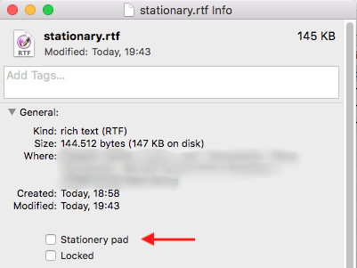

Until this has been fixed, I thought I might be able to use .rtf files as Stationary pad in the Document Manager because, when opened, a copy of the original file should be automatically created, but alas, Nisus doesn’t seem to recognize Stationary pads in the Document Manager. Moreover, if a Stationary pad file is opened in the Document Manager, altered and saved, the Stationary pad attribution is removed from the file in the Finder!

Locking the file in Finder > Get Info does work. NWP can still see it in the document manager and open it. If you try to modify the file, NWP warns you that it is locked and gives you the option to unlock it or save a copy.

Bob Stern wrote: ↑2022-03-14 16:45:48 Locking the file in Finder > Get Info does work.
Thanks for your suggestion, Bob, but for clarification, are you referring here to files that were saved as Rich Text Files? If yes, then I have already tried that, but it's a bit tedious; you end up with two open documents, the duplicate and the original file which you need to close to get it out of the way.
The document manager can also see .dot files, of course, but can't see what's inside them. That's the main theme of this thread. :–)
