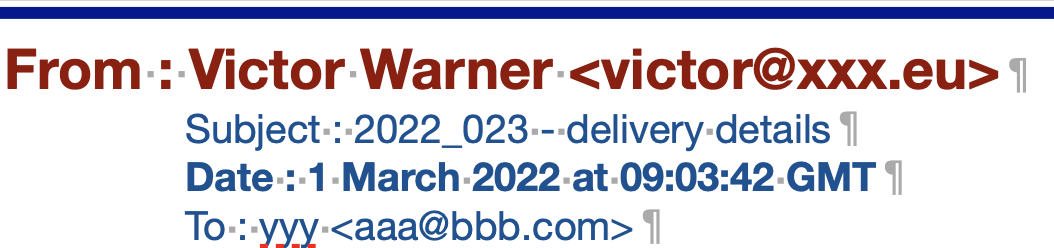

I have found (I hope) the issue: the subsequent email headers had soft returns rather than hard returns, so this is was the reason why the search failed.
However, now the search proceeds it leads to a formatting issue.

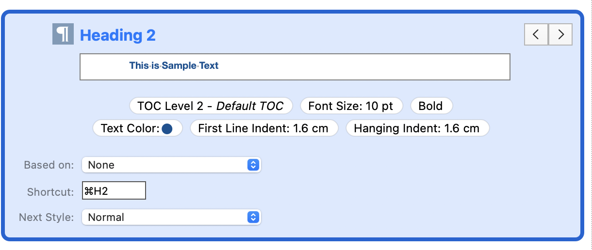

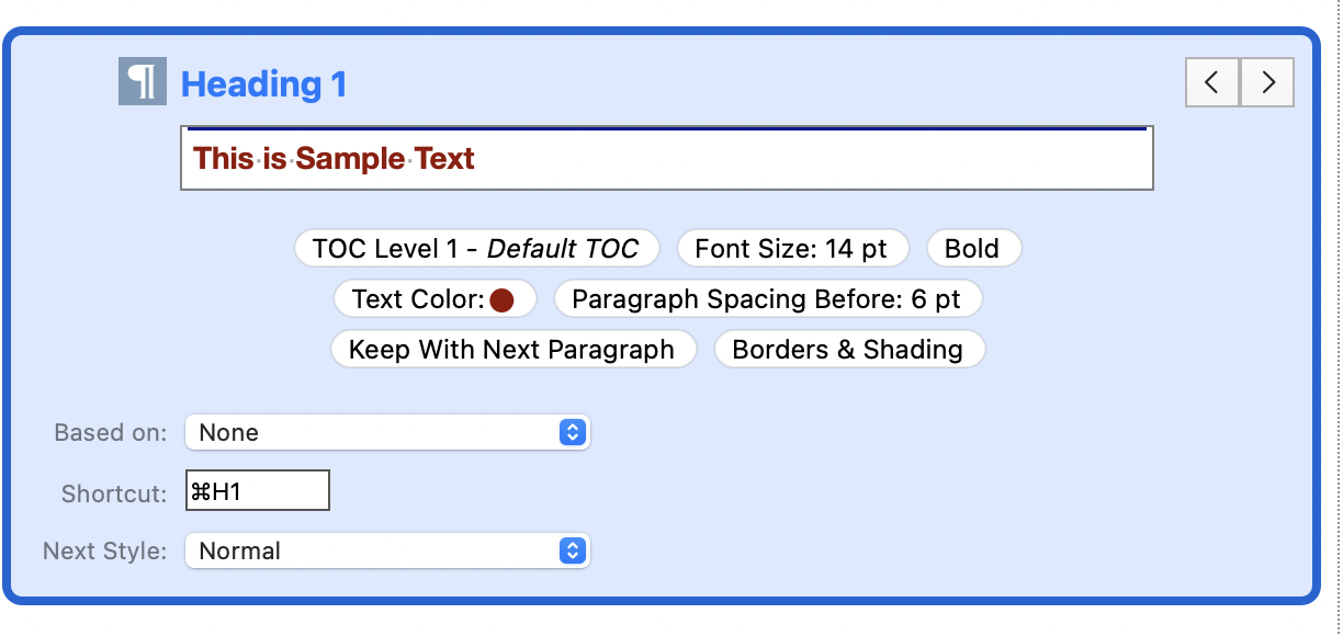

I have set up "Heading 1" and "Heading 2" to be in different colours, different sizes and both in bold. Heading 2 is applied to 3 lines in the header of each email (Subject:, Date: and To:).
But the result is only one line of the 3 is bold although the other formatting is correct, see example and how I set up the two Heading styles

Posts: 625
Re: How to search for text and apply a style to it
G'day, Victor et al
I set up text, Styles and Macro code just as you and Philip have posted, and it all works OK for me.
One thing that can cause things to become unstuck is the operation of a pre-existing defined Character Style that explicitly unbolds the character format. This Character Style will remain respected even though a subsequently applied Paragraph Style calls for unbolded text. Try removing all Character Styles in the four lines (eg, by unticking them in the Character Style list in the Format menu) before applying the Macro.
If a problem remains, you may need to attach your Macro file and a file showing the original email header text you are working with (suitably altered to retain privacy as desired).

Adrian,
Thank you for the review.
I added a step in the macro to remove all Character Styles which fixed the problem.
