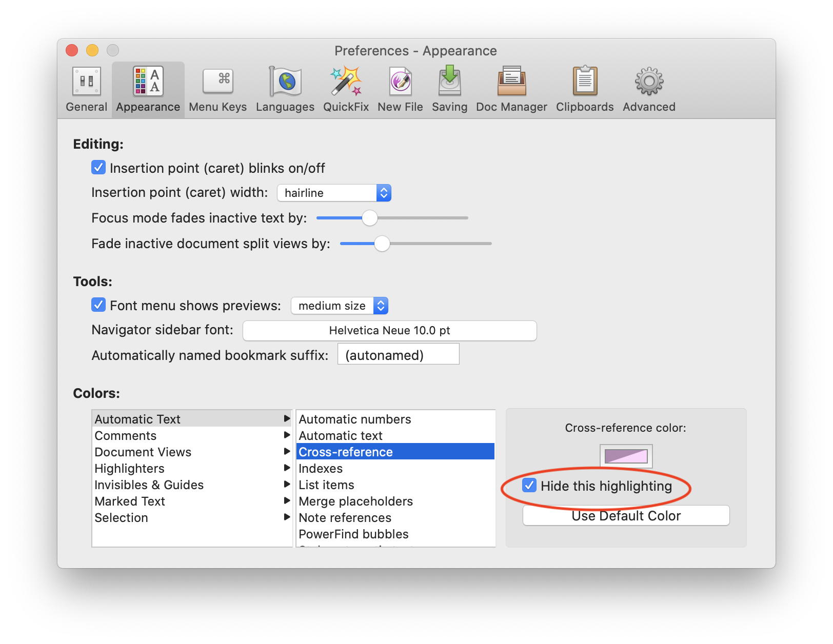

Cross-references are supposed to take on the formatting of the text they are inserted into.
But in the preferences under appearances you can adjust the way they are visible. The default is that they are hidden but you can toggle them on.
Screen Shot 2020-09-11 at 14.47.jpg (169.53 KiB) Viewed 8540 times

editor10 wrote: ↑2020-09-10 21:36:13 1. how can I format the visible cross-reference text so it has its own identity, and
2. Same question for the target of the cross-ref.
Philip already covered question #1 and showed the preference that allows you to enable on-screen highlighting to show cross-references. The same section of the preferences can help you with question #2. The target of a cross-reference is a bookmark. To show them on screen you should show the coloring under Marked Text > Bookmarked. You probably want to enable both regular and automatically named bookmarks.
