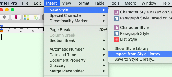

If you want your style "Bullet" to appear automatically in every new document you make from now on you shouldn't save it in the Style Library. You should add it to your Nisus New File. You can get access to that file in Preferences > New File > Advanced.
The Style Library is more like a repository where you keep specialized tools that you may want to use on occasion. You get styles from the Style Library into a currently open document in any of a number of ways:
Method 1: using the Menus. Insert > New Style > Import from Style Library…
This will give you a list of all your styles in the Library with checkboxes. Click on all the ones you want to add to the document

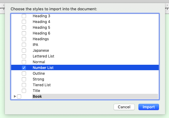

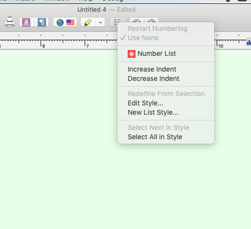

raybythelake wrote: ↑2020-04-20 11:00:22 Using your method #1, it lets me select the library and says it's inserting the new style from the style library, however I cannot see the style in the style set of the new document. Strange. This seems like it should be easy, yet it's still eluding me.
I'm not sure what's happening here. But let me say first, that in your screenshot you seem to be trying to import a list style. List styles will show up in list style menus, not with the character styles, just to be clear. So here my screenshots of the process:
Import style menu:
Screen Shot 2020-04-20 at 20.51.58 .png (205.45 KiB) Viewed 23725 times
Choosing the (List) style:
Screen Shot 2020-04-21 at 14.26.19 .png (83.33 KiB) Viewed 23725 times
Checking that the List style has been imported:
Screen Shot 2020-04-21 at 14.27.09 .png (109.54 KiB) Viewed 23725 times
