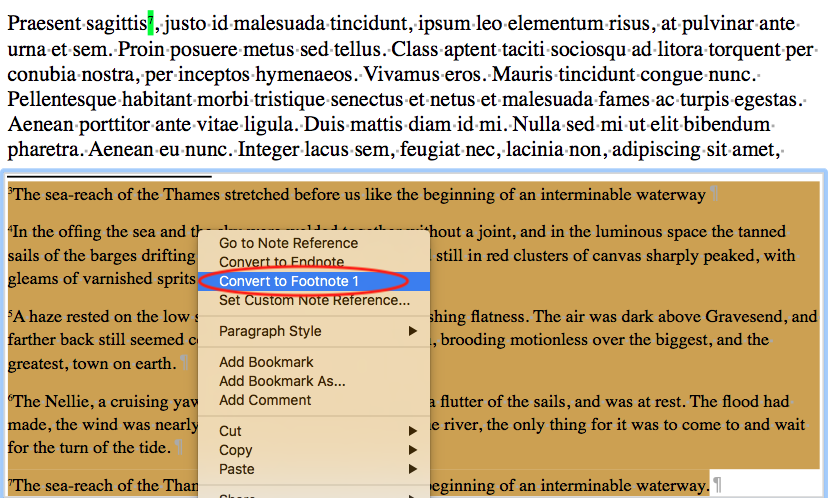

withoutFeathers wrote: ↑2019-12-13 11:59:35 It seems there should be possible to apply a style to a footnote page, perhaps within a section, to change "One Note per line".
Hello wF and Philip,
Yes, this is exactly the idea I had first. But as I went along, I think I might have discovered one or two bugs. Assume we are on the page with the 6 footnotes.
(1) Insert a section break (Same Page) after the last character on the page.
(2) Then go to the previous page and insert a section break (Same Page) after the last character on that page.
(3) Now change the document view to Style Sheet and scroll to "Note Styles."
(4) Select the Footnote style, press Command c and then Command v. You will be asked to rename the new pasted style. You can just accept the suggested name "Footnote 1"
(5) While "Footnote 1" is selected, disable the option "One Note Per Line" and go back to the Page View.
(6) Now select the 6 footnotes and right-click on the text. You'll see an option called "Convert to Footnote 1." Choose this option, and now all the 6 footnotes will be put on one line.
As we see, there are vast horizontal spaces between the notes. This really looks ugly. If I remember right, this was different in NWP version 2. Anyway, I can't find a way to reduce these spaces. Is this a bug?
If we now save, close and re-open the document, we can see that the style "Footnote 1" is gone and the 6 footnotes have reverted back to the style "Footnote." Is this a bug? If not, why does Nisus allow us to create "Footnote 1" in the first place? It doesn't make any sense.
The only way to retain "Footnote 1" and the 6 footnotes on one line is to save the document as PDF.
