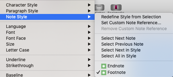

I have opened in NWP a large RTF file prepared in a different word processor. There are 500 footnotes in that file, and they should all be styled in the same way (obviously).
Now the formatting of the first 485 of these follows the Footnote Note Style, which is good, but for some reason the last 15 footnotes are shown with a font override. I cannot see any way to remove this override. How can I remove overrides in footnotes?

Hello Shmuel and welcome to Nisus,
The first thing to be aware of is that the Note Style "Footnote" does not really have anything to with the text styling of the footnotes, but rather it determines other aspects of the footnote such as numbering etc. You can apply any other kind of text formatting you want to the footnotes including paragraph styles.
So you might want to create a footnote specific Paragraph Style and then apply it to all your footnotes (this can be easily done in one operation). You could then use this style to give them uniform font and font size, for example.

Re: removing attribute overrides in Footnote Note Style
The normal way to do this would indeed be to click in a footnote and then do "Select All" twice. (The first selects, the note, the second selects all notes.) But you seem to want to avoid having to click in the note first.
Thank you, philip. This makes sense, and it worked very well (didn't know about the benefits of clicking Select All twice!).
