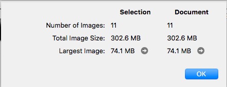

I'm sorry you're having trouble with a particular document. From what you described regarding very slow saving, you probably have an embedded image that is very large in terms of its data size (in bytes). When you insert a graphic Nisus Writer preserves all of the original image data, even if you resize the image to appear smaller on screen.
Did you insert any large photos, PDFs, or schematics into your document? These days it's not difficult for a single image to be incredibly large. I've seen panoramic photos taken by my iPhone that are each around 30 megabytes in size.
One tool you can use to help you identify large images is the menu File > Image Analysis. It will show a summary information for the current selection and whole document, including the largest images. If you click the little arrow buttons next to the "Largest Image" labels you'll be shown a full list of all images in your selection/document, sorted from biggest to smallest.

Yes I was just looking at that. Although at this point I do not understand what is going to be an optimal size for an in line graphic in size.

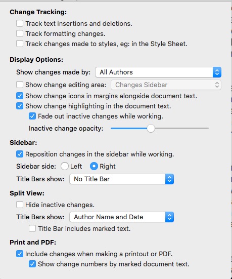

martin wrote: ↑2019-08-20 10:08:14 One other thing to check: do you have tracked changes enabled for your document? You might be accruing a huge amount of prior text or images, especially if you keep trying to fix your "sick" document by copy-pasting the images over and over. That could continually multiply the images in your document, further increasing its size.
I have not used that feature although it is possible that it somehow became set without my knowledge by a random key command ... (?) I am posting a screen shot of how my track changed are set now and if this looks like it is doing as you were asking after, please let me know.
I turned on show invisibles and, if there is anyway I can learn about the problem and correct it myself, I will be happy to try out any suggestions. Mistakes are after all the best way to learn. Otherwise I will send you the file to review as you offered.
Screen Shot 2019-08-20 at 12.56.55 PM.jpg (77.92 KiB) Viewed 22843 times
Screen Shot 2019-08-20 at 12.51.14 PM.jpg (17.57 KiB) Viewed 22843 times
Re: Sick Document
Your screenshot of the tracked changes options window shows that you do not have tracking enabled. So that's unlikely to be a problem. It's still possible your file has tracked changes that were recorded earlier, but that's unlikely, especially if you didn't turn it on.
However, your screenshot of the image analysis does indeed show a huge image. Your largest image is 74 MB (megabytes). That is huge! Much bigger than you need, no matter what kind of output you're doing. And that's just a single image. If you have many images of that size in your document, you might even near a gigabyte of data just in images. That's definitely not what you want.
If you click the little arrow icons in the Image Analysis dialog it will open a list showing all images in your document. You can click through that list to highlight and select the offending images. You should resize them externally, so they are reasonably sized.
