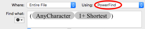

There's a variety of ways to do this, but here's what I'd recommend: Set the Find panel mode to "PowerFind" and enter the following expression:
You can insert those grey bubbles using the button with the gear icon under "Find what".
Note: The repeat bubble "1+ Shortest" is necessary here (instead of just "1+" or "AnyText") because otherwise the match will be too "greedy" and match text between multiple sets of parentheses.
Once you have the find expression in place, click the Find All button. That will select all matches in your document text. Now click the document window to activate it, and then use whatever tools you normally prefer for formatting text, eg: the Format menu. Nisus Writer lets you format multi-part selections no matter how they were created

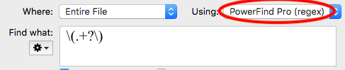

If you prefer to use regex (regular expressions) then you could instead use a pattern like this to select your text:
