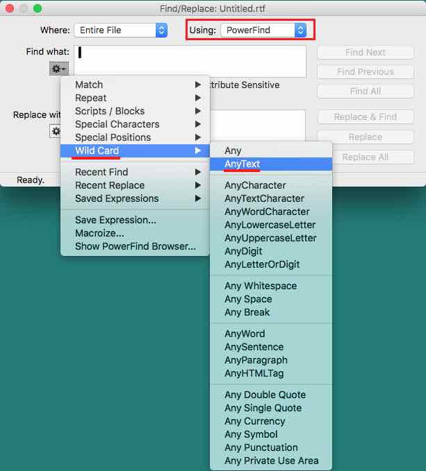

a) Open the Find & Replace box
b) Make sure you are using
PowerFind, which gives you the 'bubbles.'
c) Put the wild card
'AnyText' from the gear menu into the Find field.
- 1.jpg (39.74 KiB) Viewed 26699 times
d) Now
double click with the mouse on the bubble 'AnyText' to select it

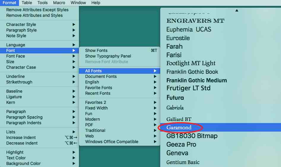

e) While it's already selected, go to Nisus'
Format menu and choose the missing font from the submenus "Font" and "All Fonts."
- 2.jpg (43.21 KiB) Viewed 26699 times

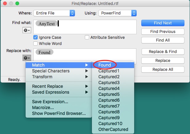

f) Now put the wild card bubble
'Found' from the gear menu into the Replace field.
- 3.jpg (78.9 KiB) Viewed 26699 times
g) Double click on it to select it. While it's selected, do the same as you did in e), with the difference thought, that this time you choose Times (or whatever installed font you would like to replace the uninstalled font with.)
