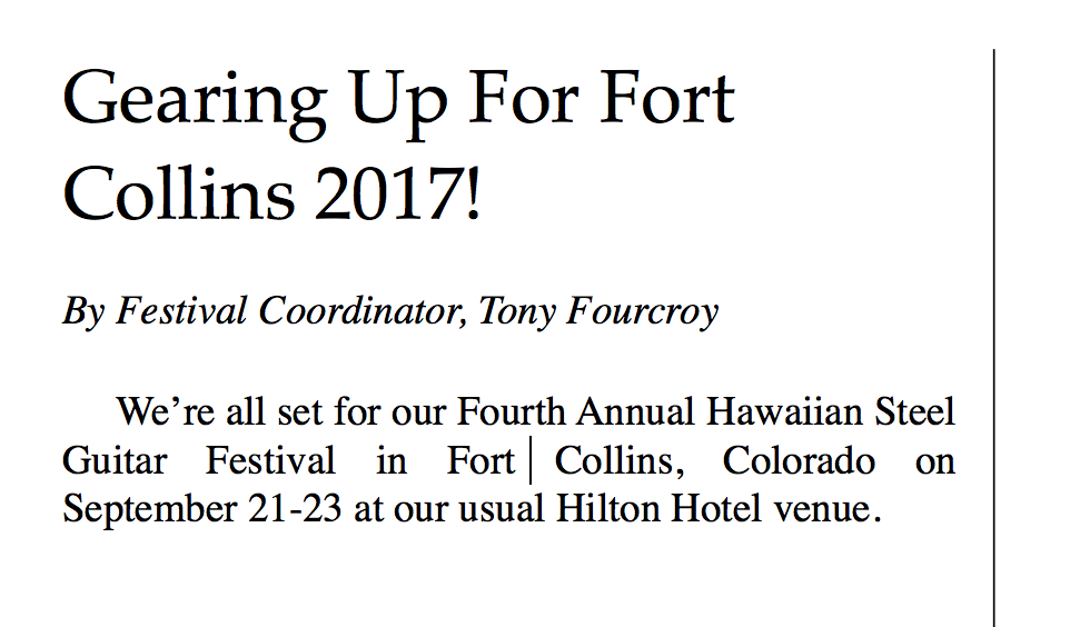

When I'm using justified text with bigger than usual spaces between words, the cursor at the end of a word is placed too far to the right, making me think there is a space character there. So when I delete it, it actually removes the last letter of the word. Does anyone notice this problem?

Hi John: I was unable to observe what you describe. Even if the spacing for justified text has gone a bit wide, the caret hugs the preceding word quite tightly:
Maybe you could share an example document and/or screenshot so we can take a look.

I'm posting a screenshot and the original file...
cursor test.rtf- (19.44 KiB) Downloaded 594 times
- Screen Shot 2017-06-20 at 10.19.37 PM.png (74.13 KiB) Viewed 8042 times

Thanks for providing a sample and screenshot John. With them in hand I've been able to reproduce the confusing caret placement.
It seems the key factor is the font. The font "Times" triggers the undesirable caret placement, while "Time New Roman" does not. Are you able to switch fonts? I hope so, because it's unlikely we'll be able to do anything about this. Text justification is handled by the system (macOS) text engine. You can observe the same behavior in other apps (eg: Apple's TextEdit).
I hope that helps.
I hope that helps.

That definitely helps! It does seem like I've seen Times New Roman much more than Times lately. Makes sense...
