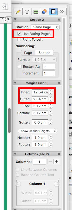

(1) Set the document to Use Facing Pages, move the inner or outer margin as desired to leave yourself room for the images, then insert each image into that empty space. (Text has to be within the margins, but images do not!) If an image requires a caption, you can use the same procedure to insert a text box (from the Insert Shape menu) below the image. This method suffers from a similar disadvantage to the one previously mentioned: you may have to drag images to the right or the left at some stage. The point, though, is that they remain the same size on both odd and even pages.
(2) Insert your image amongst the text between margins, then in the Shape Wrap palette set the Placement option to “Moves with paragraph”, set the Alignment option to “Align Left (or Right)”, and set the Text Wrap option to “Text never appears to the left (or right) of the shape”. Set the Horizontal Padding to something that looks nice, then increase the Vertical Padding until no text remains in the same “column” as the image. This method has a similar disadvantage to the other two, but with added complexity when dealing with multiple images in the same “column” of the same page. To get around this, one might consider inserting a “full-height” blank rectangle with appropriate Alignment and Text Wrap settings to banish body text from this privileged area within which one could overlay images at will. You would group the images and the underlying rectangle into a single Shape to make any required left/right shifting easier.

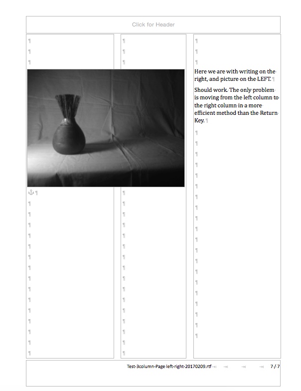

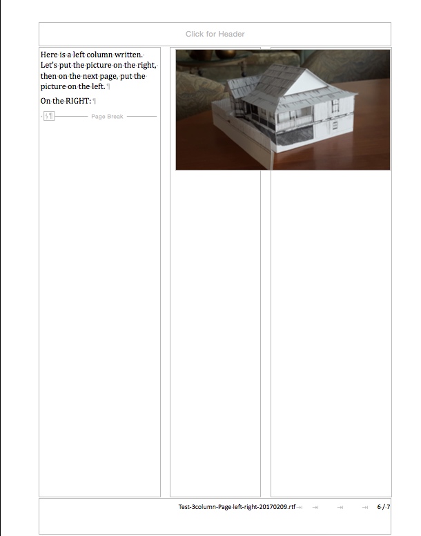

I rarely use this forum, but when I do, I’m always amazed by the helpful ideas members generously provide.
In this case, Phillip’s caution was appreciated. But his idea of the single column (which I tried) made for lots of work (even with a macro), as it would have to be repeated for every other page (I anticipate my instruction book will have 80% of these.)
On the other hand, Andrian’s suggestion that within a section the column(s) attributes did not change, and picture size was independent of column width. I did a sample, and it got me thinking.
Then it hit me! Why not have 3 columns for the entire section that I wanted left and right pages to be different with pictures placed toward the gutter on the right and left, respectively.
Whenever I wanted to write on the even pages (left side of an open book), I would use column 1 of 2.25”, and just drag the picture to the right (towards the gutter), once I tied it to a paragraph. The picture would be 4” wide. Then, on the next (odd) page, I would just write on the 3rd column of 2.25” and drag the next picture to the left (towards the gutter), once it was tied to the paragraph on the 3rd column. The 2nd column would not be used, so it’s width would be determined by the widths of the 1st and 3rd columns.
Hope my example jpgs are included in this answer.
Thanks for you ideas, Phillip & Andrian.

- Test-3column-Page_right-odd.jpg (62.58 KiB) Viewed 26452 times
- Test-3column-Page_left-even.jpg (63.63 KiB) Viewed 26452 times

The attachments you posted are very helpful in showing us the book design you are aiming for. Thanks for that.
Law of Nature: If you find yourself using multiple consecutive paragraph returns, you’re doing something wrong!
In the present case, use Insert > Column Break instead.

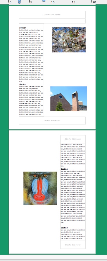

Re: Differing Sized Multi-column Pages Change Across Even &
Well, I'm glad you found a solution that suits your needs, but I think you misunderstood what I was suggesting. My idea was to set the margins of the single column asymmetrically. After that "Use facing pages" does the rest. So it's actually no work at all. You don't even need to insert column breaks, and you can have text which flows from one page to the next.weiphotoarts wrote:In this case, Phillip’s caution was appreciated. But his idea of the single column (which I tried) made for lots of work (even with a macro), as it would have to be repeated for every other page (I anticipate my instruction book will have 80% of these.)
Admittedly there is one downside to this approach. Nisus unfortunately limits the header and footer along with the margins. So if you want centered headers or footers over the whole page width, your approach is probably the way to go.

G’day, Philip et al
Yes, Philip has demonstrated exactly what we have in mind.
However, although text will flow properly from page to page, images will not. That is to say, if text alteration forces an image to move to another page (specifically, one that is an odd number of pages beyond the original), it may end up overlying text, so it will have to be displaced manually to the left/right. Depending on where the image anchor ends up, the image may also have to be displaced in a vertical direction as well.

And thanks for that macro and the explanation, Philip. I now see how to access the required parameters. With two modifications and some tinkering with the intial values of the position variables, the macro is a joy to behold in action.
The first modification is addition of the standard access line:–
The second is replacing the two occurrences of the “<>” comparison operator (from Numbers and such) with “!=” (which Nisus uses).
Great fun to see images move into those margins on odd and even pages!
One subtlety to be aware of is that Text Wrap in the Shape Wrap palette needs to be set to “Text placement is not affected by shape” (ie, middle button in top row) when inserting an image. Otherwise, the image will displace text and perhaps lead to confusion until the macro is run.
As Philip says, the vertical situation gets a bit complicated and may well be better done manually (which would be a pity!). One thing that is not quite clear to me yet is how the choice of Placement in the Shape Wrap palette will affect things. We know it can’t be “Inline with text”, but I’m not sure which of the other two options is best in this situation. Another day….
