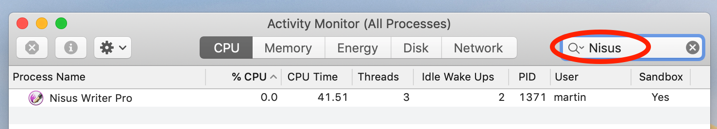

2. In Activity Monitor's listing of all running apps, select Nisus Writer. It helps to use the search field to narrow the list:
