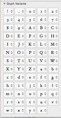

withoutFeathers wrote:[...]does your version 8 have alternate glyphs?
Yes, it does:
One thing I noticed is that Hoefler does not have the soft hyphen character; when a soft hyphen is used, it is substituted by Times.
